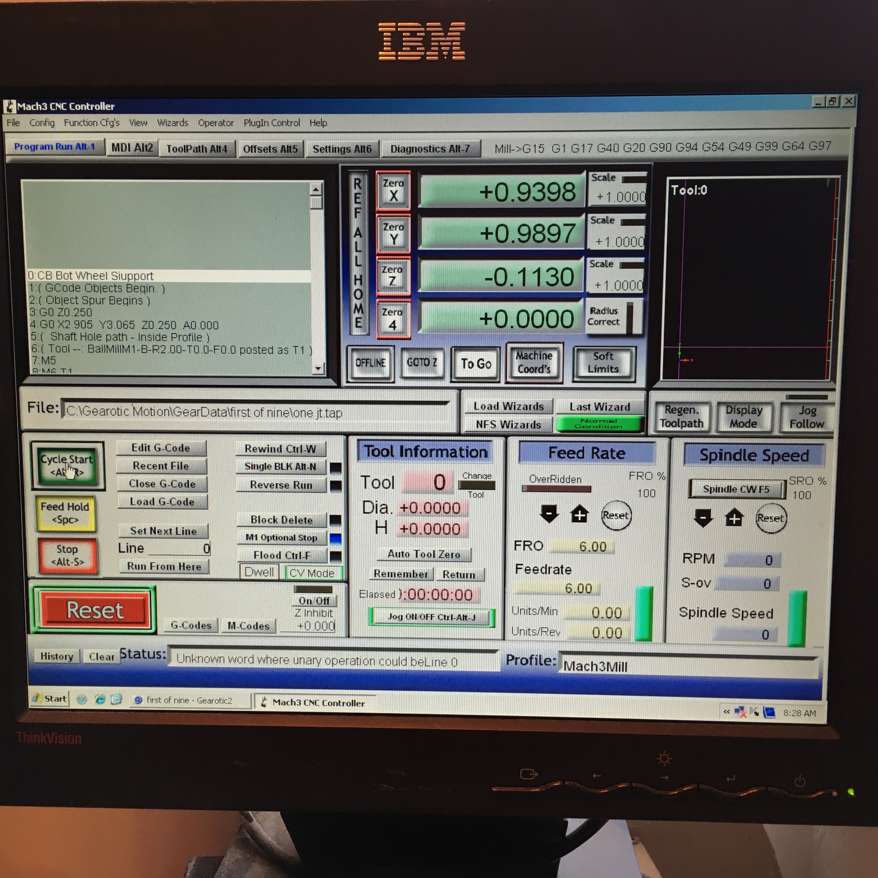

When I load into Mach3 (see Photo) there is Gcode there but there is not diagram on the table screen at the right.
I can open the gCode from the edit button and there is lots of code there
When I push the cycle start absolutely nothing happens no message no motor movement just the same screen.

The Status line is reporting "Unknown word where unary operation could be - Line 0" which is the machine not recognising what the text in Line 0 is. Delete Line 0 or put brackets round it and your GCode should run.

That fixed it - I'll have to watch for that next time. I think its coming off the epi / pro log edit when I post the code.
