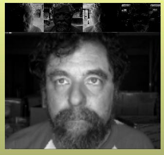

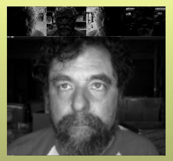

The captured images don't look very good. I thought that it was exposure so I changed the Aquisition speed.
I switched to a TV screen that is 38" diagonal. I taped the webcam to the center of the screen and turn the lights off.
Aquisition speed questions. It does not seem to make much difference here is 25ms
and here is 250ms
Aquisition speed does seem to increase the confidence but I'm gettings numbers in the 20-50 range.
I also have to change the Y fisheye correction and the gradient scale to get anything like my face. One benefit is that the rest of my head looks like the Greek god Hermes
and here is 250ms
.Aquisition speed does seem to increase the confidence but I'm gettings numbers in the 20-50 range.

Hi Alber:
Not unusual to get output similar to what you show. I found I had to play with the camera settings like
white balance and such to tame it down. I also recommend clipping it, this removes the drawn out background.
the output varies a lot though depending on camera used, monitor, darkness..etc.
Play with the settings, its really a matter of finding the sweet spot.
