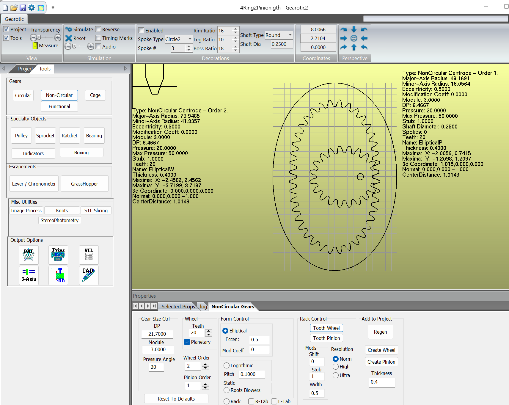

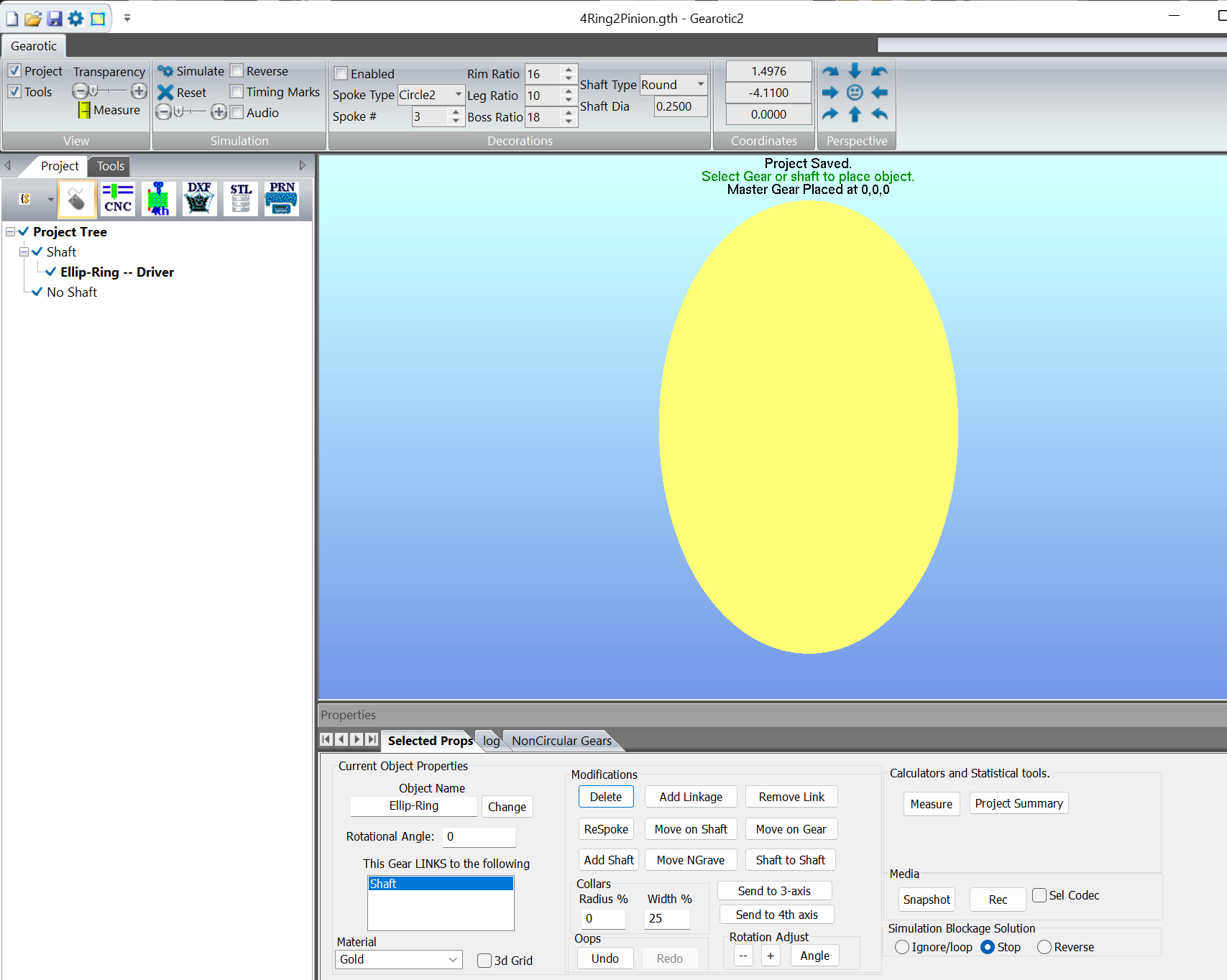

Things were going well. I made my first project with non-circular planetary gears. But then I wanted to modify my design to use fewer teeth to compensate for some assembly slop. Now, every time I add my planetary to the project tree, the entire ring gear gets filled in with a solid color. And when I return to the NonCircular Gears tab the teeth are gone from the ring gear. I've attached screenshots. What could I be doing wrong?
Thank you for your help.
This is like the teeth for the ring gear isn't a closed graphic and so when it gets colored the entire space inside the outer boundry is colored.

Hi Bob:
Is this continuous on all planetary's from this point on? If you add or subtract a tooth does it still fill in?
The non circulars are made from a process of rack subtraction in a virtual sense. Its possible at some
settings that the subtraction fails and generates a profile with a hole that fills up. Sometimes just changing the module by .001
can fix it, or adjusting some other parameter. IF though, it now happens on all the planetary's you make,
upload a project file here so I can attempt to reproduce it. Ill issue a fixed version to you if I can see it.

First I opened up my successful project and the project tree looks good. But I can't go back to the "NonCircular Gears" tab because I must have accidentially saved on top of it and I don't see a way to get what is in the project tree back into the gear module. There doesn't seem to be a "Send to design" for non-circular gears.

To reproduce the problem I created a new project:
Go to Non-Circular in Tools, reset to defaults. Click Planetary, set wheel order to 4 and pinion order to 2. Tooth the wheel and pinion then click Create Wheel. Ring gear shows as solid in Project tree.
I fooled around with changing the Module and other settings but without success. I kind of feel like I'm shooting in the dark here.

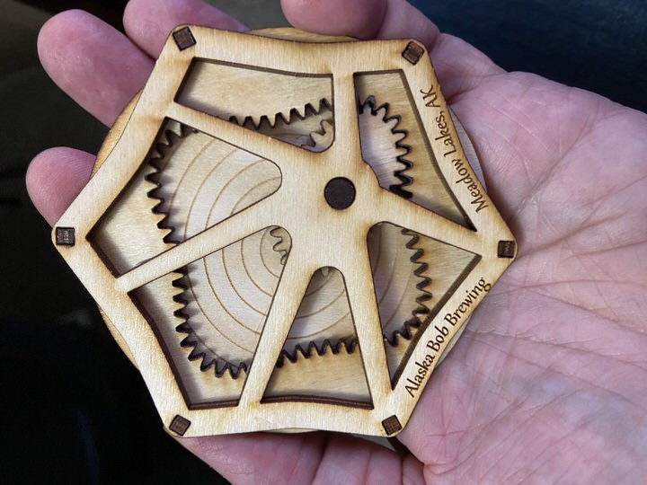

For what it's worth, for this first project I'm creating little drink coasters. I've done other kinetic coasters and thought non-circular gears would be kind of fun.
