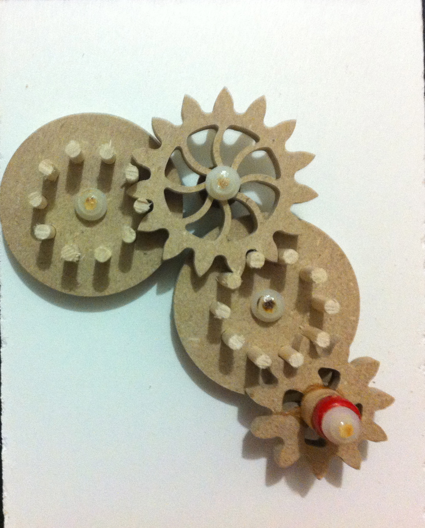

I'm not sure that Kirk and I are talking about the same thing or not.  I'm referring to the distance from the edge of the pin to the edge of the disc.  It really has nothing to do with the gear design only the outside "rim".
I include a photo - Obviously its not a problem in this photo but I have had problems in other sizes.
Hope this helps.

I meant the same thing as John - my lantern was pretty small, and the pins touched the outer edge leaving small gaps instead of a continuous rim.  This made the cage weak enough the resulting small triangles broke at the narrow point between the pin holes when I tried to insert the pins with a pair of tweezers.  A thicker rim would have held it together.  The pinion was fine.
I found the old project file, 6 pin lantern, 56t pinion, 1/8" pins.  It's attached if that helps.
Re: Rim Thickness Control
ArtF wrote:Just so I understand properly, you mean the disk outside needed to be larger to have bigger gaps in the teeth?
The lantern disk outside the pins needed a wider rim, i.e larger diameter disk without moving the pins..  John got tearout, in my case the pins were flush with the outside of the rim and actually left a small gap over each pin.

  No need, Version 8.1 now uses Rim% on the spoke panel to control the disk size..
