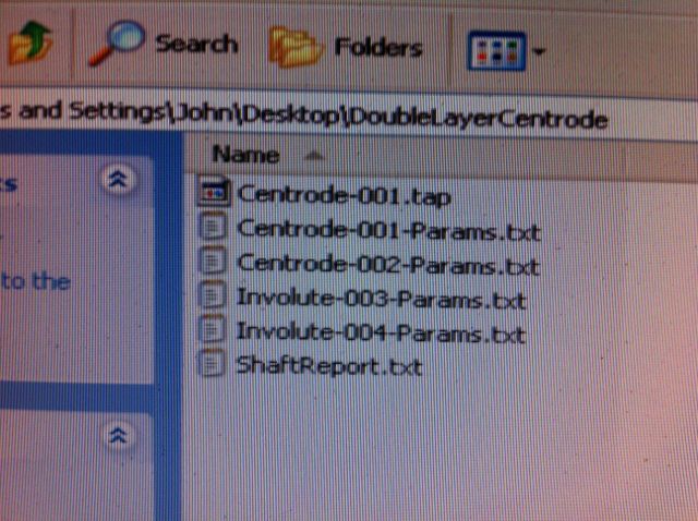

I've noticed that I can't seem to get several gears to output either DXF for .tap files at a single try.  I select all the gears I want to output and everything appears OK but when I go the file folder there is only one tap file and I have to repeat the gears individually to get them to Mach 3.  Once in Mach 3 they cut perfectly.
Re: Multiple Gear Outputs
  Are you pressing the "Copy to all gears" button after selecting dxf or tap? If you select the variosu gears on the output manager screen, the selections change depending on what you stored there. Select several gears and then select output manager, then check DXF and press "Copy to all gears". Does it then put out multiple files?
My apologies - all is well. :-\
