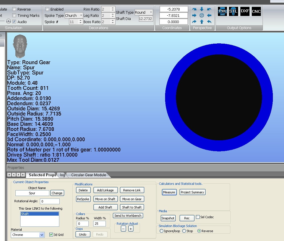

There is still some sort of limitation on the shaft size - it appears to be limited to 12.27 where I would like 12.43 for my project.
I've used a spur gear with 800 teeth, because when I strip the teeth they are so small that I don't notice the change in diameter.
I can live with what I've got but thought you might like to know the shaft diameter limitation on the spur.

Along the same lines, I need to make a circular disk and would like to use the same spokes as the rest of my project. I tried setting the number of teeth to zero and really bad things happened.
Is being able to do stuff like this still in the works?
Re: Making a Ring
To do that just make any gear with spokes, then , on the project tree right click the gear and select "Strip Teeth", and youll find you have that spoked ring.. :)

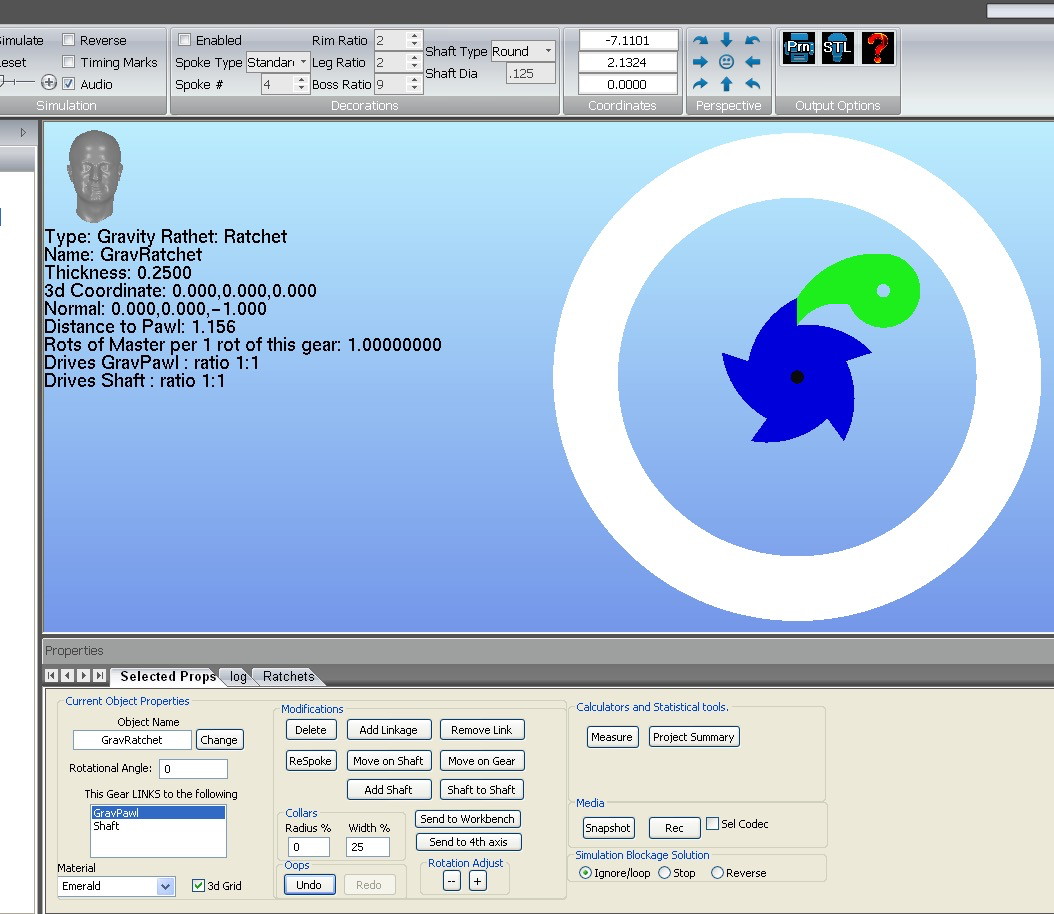

I don't want to reopen this particular issue as I have workable work around as we have discussed above.
I would like to be able to create and "array" of pawls around the ratchet. When I add either a ratchet or the "pinion" I get both the pawl and the ratchet added at the same time (either by clicking ratchet or clicking "pinion"). I would like to be able to put 5 pawls around the ratchet. It is possible = sort of but I end up with 5 ratchets as well as the 5 pawls I want.
Another little issue is in arranging items on the workbench - if one overlays another I can't select the lower one to select or move it - I always get the top one.
Re: Making a Ring
Ill add to my list to see if I can easily separate those two items from one item to separate
items for the purpose of machining...
Re: Making a Ring
I see I misunderstood. You can already machine multiple pawls.. you just cant have them on the project screen working..
Ill add this to my list for adding more around the ratchet.. but Im thinkin when I get to a cad module it may solve that itself..
