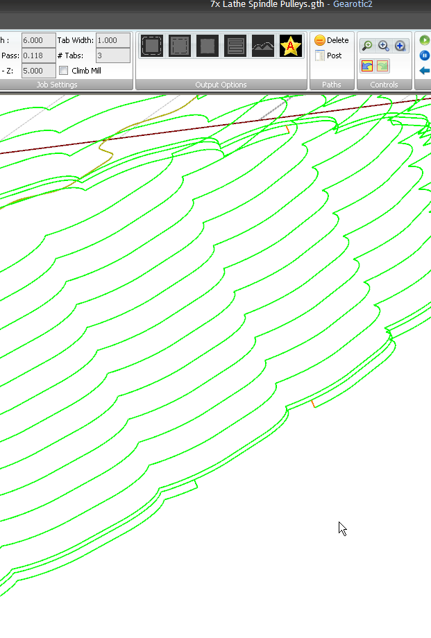

Your tabs are therew. their just small. The tabs exist from final pass depth to full depth
at the width you requested. If I tilt your toolpath and look I can see them. ( Look at the bottom of this graphics..
youll notice the tab..)
