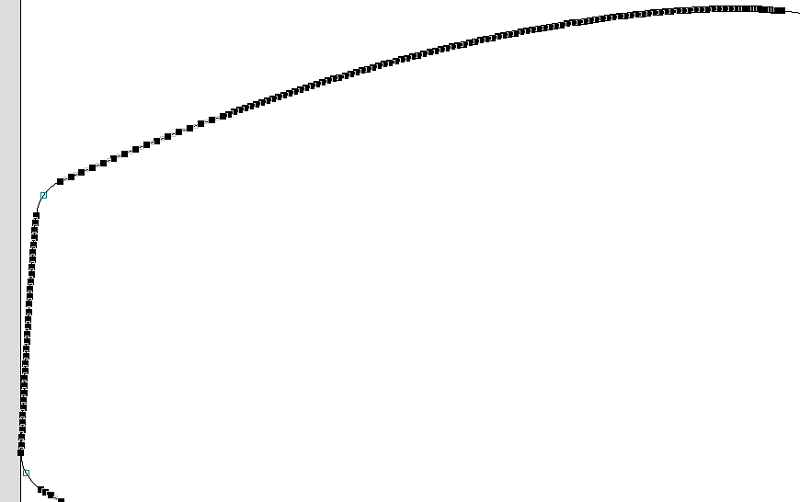

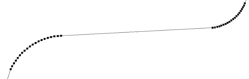

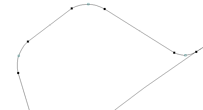

I tried a clock face and a flourish they all have to many point for fusion to handle. after some more digging if the .dxf is made up of lot of little lines what fusion does it has a point, line point, point, line, point, point so on.
if I highlight the dxf you can see the points.
if the arc's are one continuous arc fusion is fine, if the ach is made up of a lot of sort lines that is what kills it.
the 3 images are from bad to good bad is from gearotic, ok is from rhino and good is the file I re did to work in fusion
