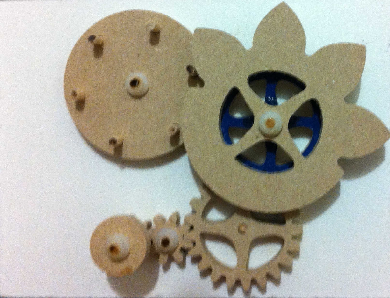

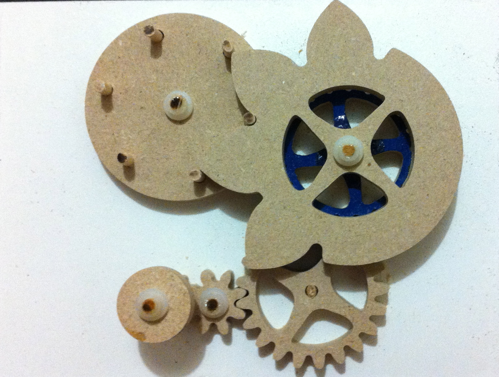

I thought I'd try something - I made a Geneva wheel with 4 teeth spaced as close as possible.  The entry into the teeth has the same bumping problem but once the teeth are engaged its smooth as silk.  I don't know if this helps you but I thought it might.
Re: Geneva Size Limitations
Yep, thats the tradeoff, between a positive locking action or looseness. I like your solutioon though, that looks like it lowers the pressure
angle enough for a more posative engagement. Ill see if I can roughly duplicate that within a couple releases. I appreciate that kind
of feedback, saves me gobs of time..

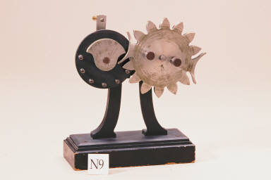

tooth to mine. A true geneva doesnt, but neither is a true geneva a gear by tight definition,  its more of a mechanism. Look at a true
geneva and youll see, as in your photo, that it has several parts, not just two gears, it has a separate locking layer which really is two more gears,
and they function as a 4 gear set really which we term a geneva mechanism, more so than a geneva "gear" set.
