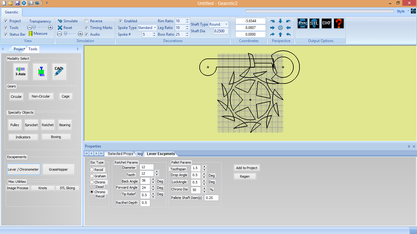

not sure if this is a bug is there anyway to get back to sensible defaults
ended up in state shown in attached image

I have on my repair list the tendency of the escapements to do this, you can always reset all settings back to zero by stopping the program with taskmanager, next start will ask if you wish to reset all settings. BUT the escapements can do this easily, so you may be better off recognizing the setting thats doing it to you, ( usually one of the angles on the screen.).

Same thing happened to me, forward angle needs to be lower. Reset unfortunately didn't fix the issue.

Vijo is right reset does not fix this problem
Plus reset loses other settings eg units
I think a "reset to defaults" like in Non circular gears would be helpful
