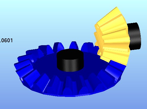

See the attached screenshots. In the first one you see the result when same face width is defined for wheel and pinion - actually the resulting wheel face width is much smaller.
In the second screenshot there is another bug, where teeth are aslo displayed on the face of the gear - actually they are seen on the back as well.

Thanks Art. Just found that the second bug only occurs with gears having tooth count of 10 or less.
