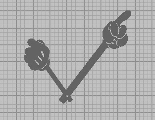

I seem to always need a very simple second hand with no muss or fuss so I followed you instructions and heres what I produced.
PS Tried to attach a .dxf of my creation but can't attach it.

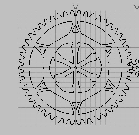

Does this work for "contributions" - or would you rather I not?
- DoveJT.dxf.zip
- (41.78 KiB) Downloaded 723 times
- lighteningJT.dxf.zip
- (14.85 KiB) Downloaded 743 times
- SimpleSecondHandJT.dxf.zip
- (6.27 KiB) Downloaded 708 times
- spiralJT.dxf.zip
- (75.54 KiB) Downloaded 732 times
