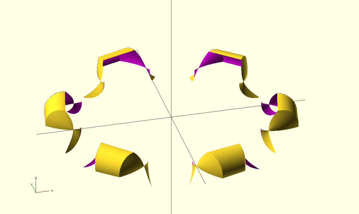

Dunno.  Here's an image of the model with top land, face and flanks.  I hadn't worked out the rest of the gear shape.

Uh... whut?

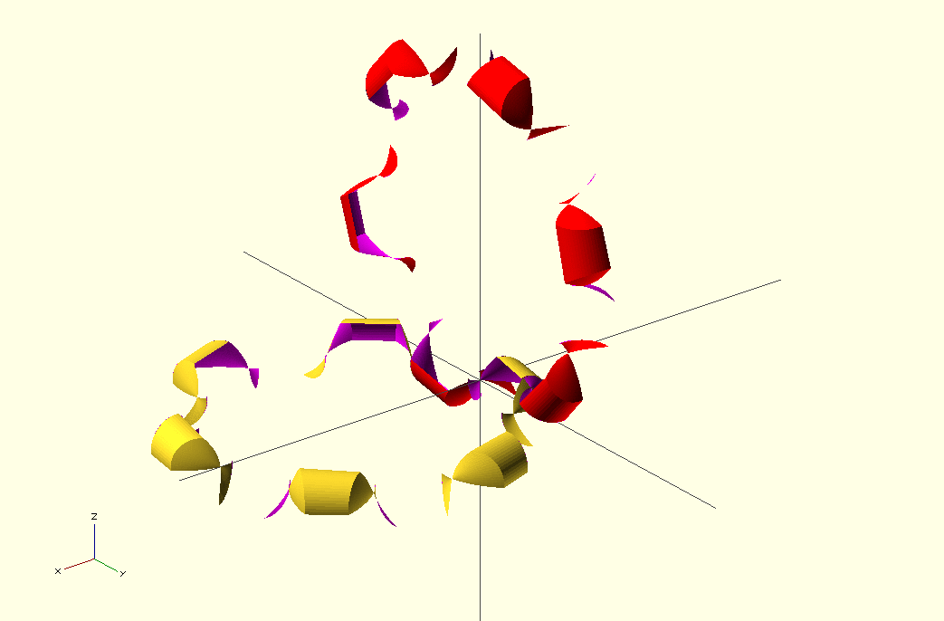

It's basically only showing the meshing part of the gear.  Maybe this will clarify it.
Re: Crown Gear
Does make it clearer.... couldnt quite see the mesh till then..
