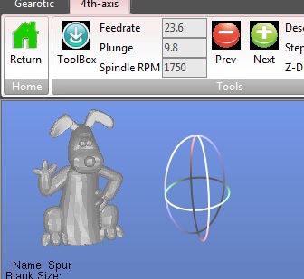

12. The status bar currently shows nothing. I vaguely recall a post about some intended purpose but I dont remember what. So how about this: remove the Coordinates panels from all the ribbons. The status bar will have X:<#.#> Y:<#.#> Z:<#.#> justified to the left; things like 'Simulation Active ~ .....' and measurement results justified in the center; Gearotic's current active mode justified to the right.
13. And now a word about Headly McGearhead... My sister says, and I agree, Headly is kinda odd. And in the new video about slicing, you mention that he lives in an STL file named 'Compass' in the install directory. So what did I do? I promptly went noodling around the internet for a more suitable successor. See the attached. But when updating to ongoing releases of Gearotic, Gromit would be deposed. So even though this would be the lowest priority of Gearotic software development, I would like to ask for a place in the options dialog to upload one's own little 3D model. Or just a choice to turn off the compass.

>>13. And now a word about Headly McGearhea d... My sister says, and I agree, Headly is kinda odd. And in the new video about slicing, you mention that he lives in an STL file named 'Compass' in the install directory . So what did I do? I promptly went noodling around the internet for a more suitable successor . See the attached. But when updating to ongoing releases of Gearotic, Gromit would be deposed. So even though this would be the lowest priority of Gearotic software developme nt, I would like to ask for a place in the options dialog to upload one's own little 3D model. Or just a choice to turn off the compass.
&nbsp;
&nbsp; &nbsp;The oblique circles were only added recenty as I figured Id eventually get rid of headly. Problem is Ive gotten so used to him I actually find him handier than the obliques ( which are basically what slicer and other programs use. ). So this one I understamd. I will look into adding an option for at least turning him off. Experienced users can replace him as they wish, much like thay can add spokes or indicators as they wish. Advanced things that I dont really inform people of, but that they can do if they wish.. &nbsp;:0
