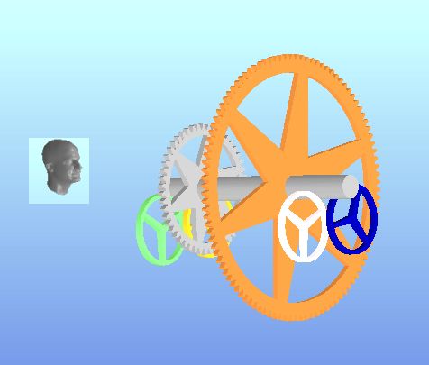

I'm experimenting some more with Gearotics2 in building simulations of clocks/chronometers.
Attached is an example that tries to simulate John Harrison's anti-friction wheels that he used extensively in his long case clocks and also in his first three marine timekeepers.
