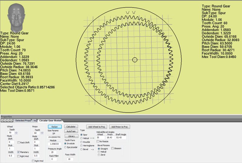

If you use an early version of Gearotic, it will give you the outline of the cutter necessary to cut the gear. For internal gears, the tooth form is different from external gears so you cannot just use an external tooth form.
I've made internal gears by making a single tooth cutter and then shaping each individual tooth. I used a milling machine to hold the cutter and push it through the brass (in this case) gear blank. Cut about 0.050" at a time IIRC. Rotary motion of the gear blank was via a Sherline digital rotary table which made it easy.
