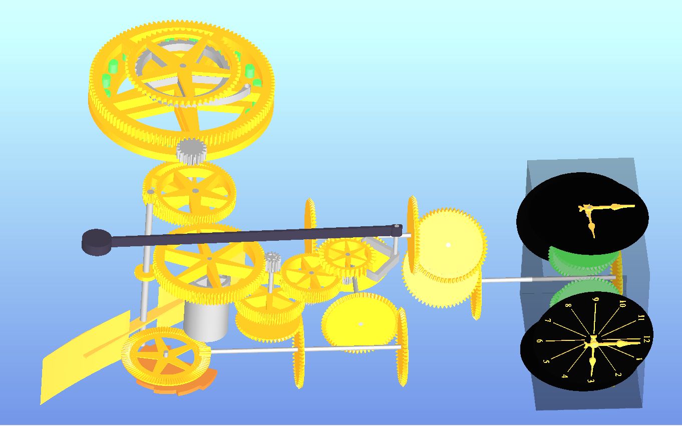

Hi Art:
I created a large simulation of an E Howard Company Tower Clock earlier this year using Gearotics.  This simulation is being used to document the design of an existing tower clock.
The goal of this post is to not only share my large Gearotics simulation model of the tower clock  but also to share custom indicators and a gear library that I created in support of the simulation model.  The model is stored on a google drive and the following  is an unrestricted link to the GTH file because the file is too large (size ~100MByte) to directly post on the forum.
https://drive.google.com/open?id=0B8aAv ... 0J0TGp5WHc
Included in this post are :
1. Jpg of my EHowardCo Tower Clock Simulation
2. PDF  EHC-Simulation-2016-0606
3. PDF  MyCustomIndicators-2016-0606
4. ZIP   MyGearData.zip
EHC-TowerClockSim
The first attachment jpg is a screen capture of the model.  If this strikes your interest then read the next two PDF files.
EHC-Simulation-2016-0606.pdf
This file describes some of the design features and trade-offs that I made while constructing the model.   I do plan to write-up a functional description of the operation of the clock at a later date.

Bill:
Very nice. Is that flutter wheel used to simply slow the chiming chain? Good idea there...

The "flutter wheel" is trying to simulate the look of a vane.  The vane on the clock serves as a governor for the strike side of the Tower Clock via air braking.  The angle of the vanes are adjustable which would change the speed of the strikes.
Did you have a chance to try the download link and look at the actual sim model?

Bill:
  I did, looks very good. I really must try to make those sims shorter files some day, but then they contain a lot of info on each gear..

I kind of hope that publishing such a large simulation model might inspire the Gearotics newbies to explore the various features built into the program...especially the ability to match existing gears either from physically measuring gears or getting general specifications from drawings or published photographs.
For example, the motion works in the model was based on a photograph my co-worker took while examining the E Howard.  I made a best guess estimate of the larger gear's size, counted the number of teeth in the gear, knew the desired 12:1 reduction and then played with Gearotics features to create the approximate gear pairs.  When we get to overhauling the motion works I'll get a chance to see how close I came to the real thing.

Bill:
  Well, youve done well.
>>When I retired in 2007, I considere d it more of a graduatio n than an ending.  I've been exploring new topics ever since.
  Me too, its where Gearotic comes from really..  I use Gearotic ( and Auggie) as base frames to hold various experiments I do, its why strange things like Web->3d exist or celtic knots or slicing, just things I happened to get interested in during the journey.
There ARE quite a few things in Gearotic poorly explained, or even hidden or not turned on. On the other hand for its
primary purpose of designing and machining gears its pretty well explained. Eventually I hope to turn more on, and tie things together better. It actually has modules for things like image segmentation and digitial subtractions and such, I just never got around to providing a way to use them. Theres just so many interesting things to explore and so little time to code.
  Great work, its quite a simulation, Id imagine the education has been fairly extensive... :)
