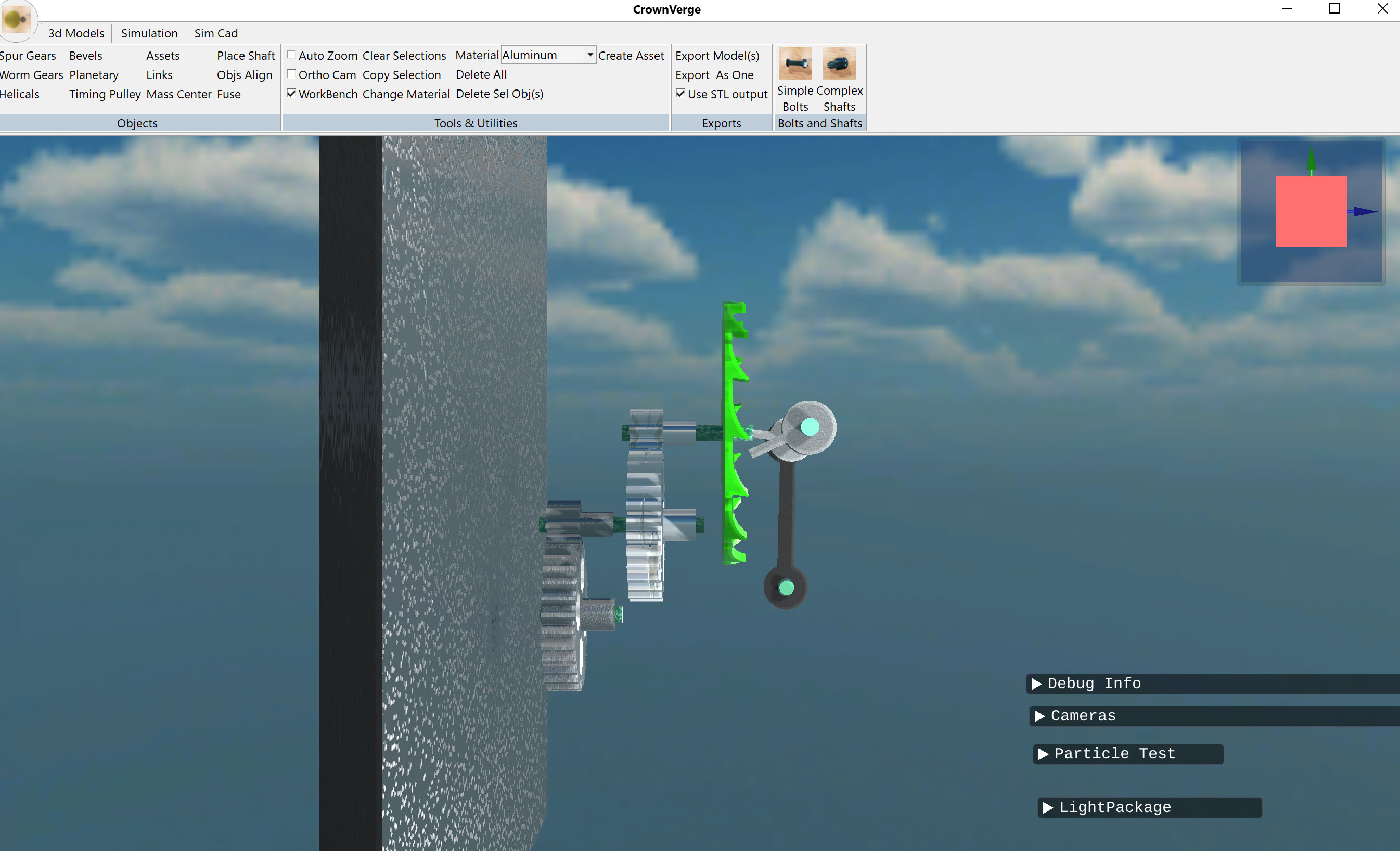

I include a couple of snapshots of what the above describes. The first ( sim) shows a
virge type escapent shown in perspective from the side, done by clicking the side

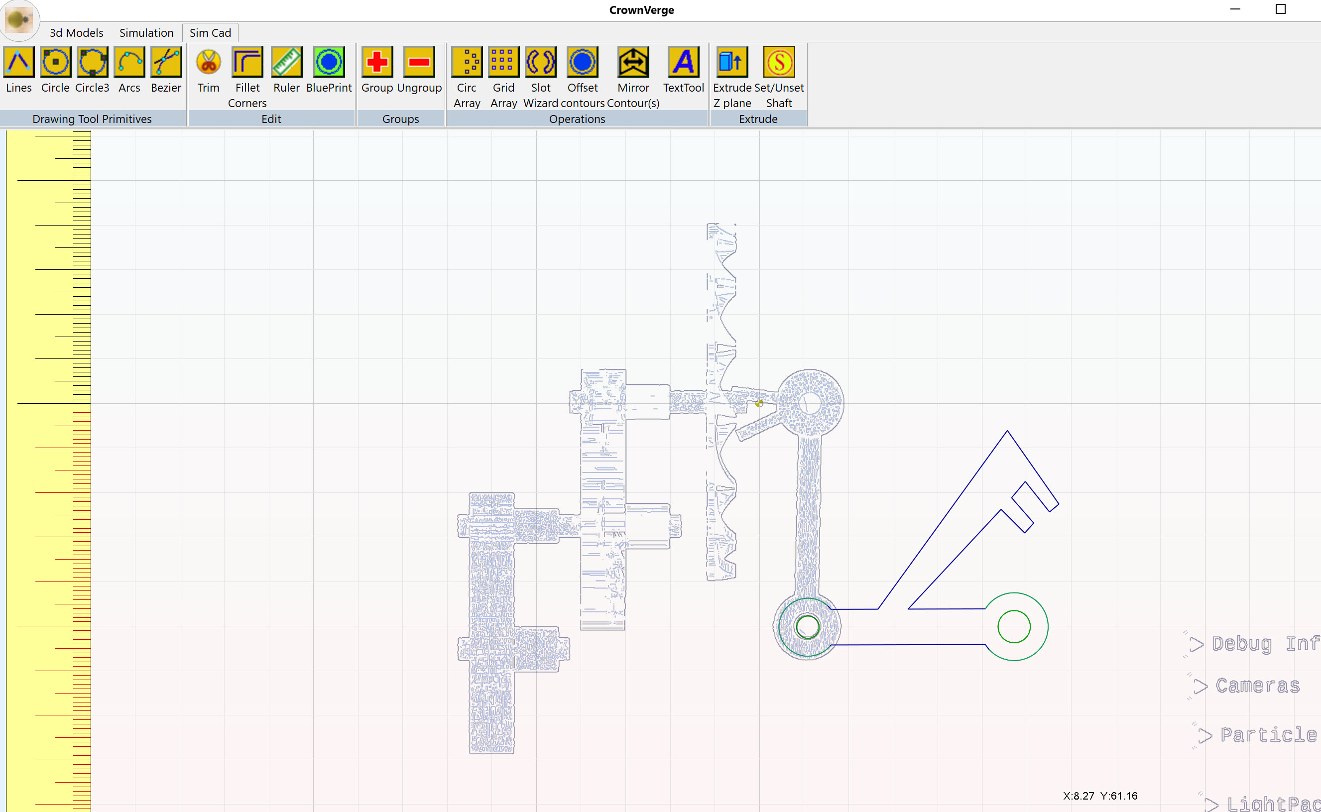

box on the top right. The second shows what you then see if you select the CAD button
and a drawing being added in context to the mechanism for rapid extrusion to that
plane for placement. The blueprint feature I am finding is very handy to quickly

The CAD module is a recoded version of Vexx designed for extruding parts. The movement,
rotations and such are all much cleaner in general now.. The worktable can be resized on the fly. Parts can be
drawn so they extrude to the plane you wish easily without screwing about with Fusion 360 or its ilk.
You can see how a part your drawing fits into your design as you draw it, that makes it far easier
to draw something as complex as an escapement.
