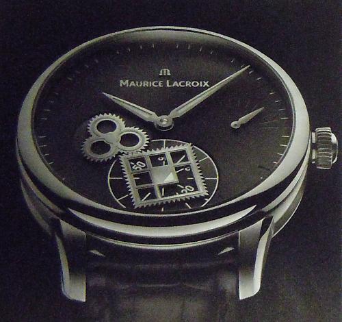

Anyway, it resolved itself after the second reload.&nbsp; I may not have exited the program after the first save and open (thought I did, but...), but definitely did the second time.&nbsp; I feel bad enough about not being sure about the first restart I won't say even anything about these very interesting looking eccentric gears from the previously posted museum link.
