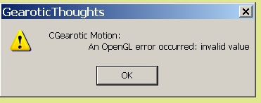

I downloaded the latest 1.02 and tried it - when I went straight to try and add a circular gear I got the same error message as before so I rebooted the program and this time tried the buttons on the top menu bar to see what would work for me and not crash the program. everything on the top bar worked fine. I checked style and version - all OK.
I went to indicators on the tools screen and that worked - after that everything worked.
So I have no idea what I did that made the program happy I only know that both me and the program are happily working.

Hello Art and Group,
I been playing around with GT this week and having a blast. Today I fired up the program and selected circle and got an error msg. :ERROR FOUND, GEAROTIC 801, ATTEMP RECOVERY? " I clicked on yes several times with no results. when I press NO the program closes down.
I've tried selecting the other options with the same results.
Any Ideas
Jerry
Any Ideas
Jerry

Re: GM, GT new release.
Good Morning Art;
I reloaded GT and selected circular and the same error message appeared.
I restarted GT and selected indicators and the program seemed to function.
I went up the selections from bottom to top, it appeared to function okay until I got to circular and selected the planetary option and added the gear. what appeared was a solid disk, no teeth.
I repeated the above several times with different DP sizes with the same effects.
I hope this helps and I'll wait for your revisions.
