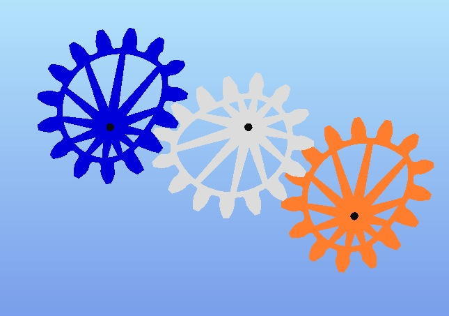

PS Meshing on blue and white is perfect Orange not so much but better that it was.

Re: New version 1.15 of GT.
  Your meshing may be off because you have a wheel running on a wheel? With modified ellipticals you can only run a pinion off a wheel or a wheel off a pinion, but never a pinion off a pinion
or a wheel off a wheel..
Ooops - sorry on the meshing third gear - senior moment!

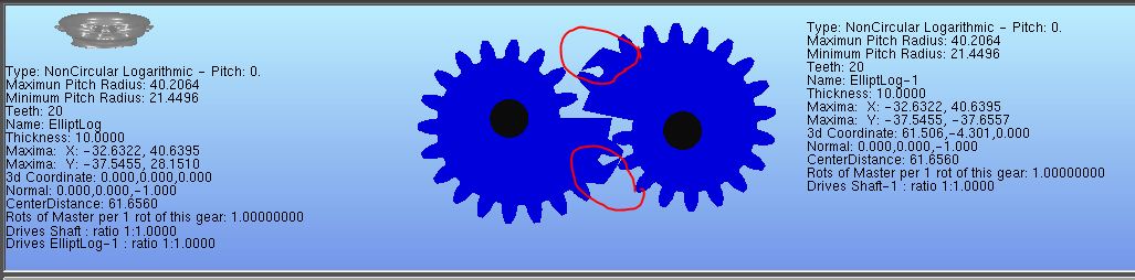

First I've had a chance to look at this.
Pressed Default and then generated the two.
what am I looking at?
Is this my computer creating an issue?
don't seem to get any complete profile with any settings for logarithmic.
Nope, bug on my part.  Set Mod Coeff to zero if it isn't, and press regen before pressing tooth wheel
when you change anything , press regen before toothing.
Ill fix it up, Its still a bit sensitive..
Ya:
  Found a couple problems, will issue a fix tomorrow, the toothing is much more reliable,
and the pitch will display properly. Couple more puppies hit the dust. :)
