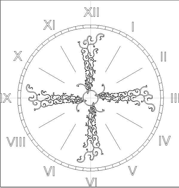

Pretty fancy clock faces are now easy to create - many thanks.

Fabulous face, and exactly what I had in mind when I jumped into the rabbithole that became
the flourish module. :)

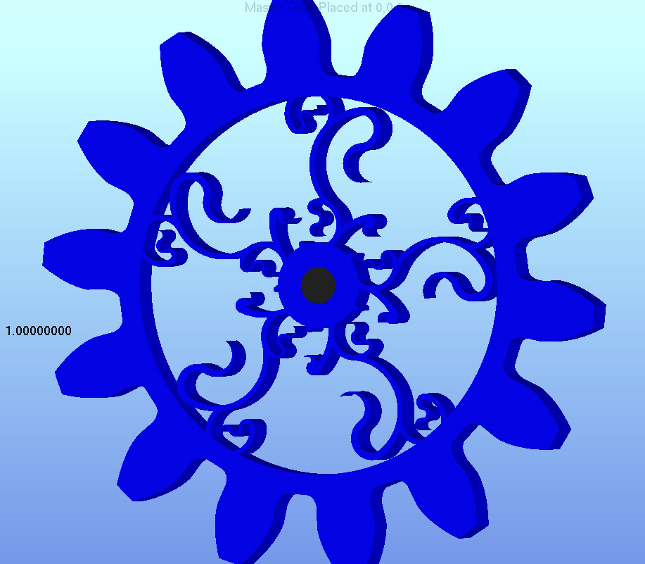

  Usually, when you press "Flourish" the system selects the "Flourishing" layer, so that if you
immediately draw a box, its on that layer. The message "No objects on flourish layer" means the
guides were drawn on another layer. Select "Flourishing" layer before drawing guides.
  Again, there can be many guides on a layer. The master guide must cover all others. All inner guides
will be exclusion guides. The outter layer may be any shape, and may be made of a circle, or lines
drawing a shape, or a box. inner exclusion zones may be any shape. Doesnt always work perfect
( what artist does.) :-)
PS: Im working on spokes to give you much wider latitude..

Post by Dan Mauch »
I love flourish. I have a 22" clock that I used v3 to make some flourish inside the clock. It took me 6 hours to create the flourish going  through many iterations until I got what I wanted and then editing out what I didn't want and creating an array with my Cad program.. My wife loves it. It is not quite finished as I want to inlay red acrylic in the openings for the Roman Numerals. BTW in the ruler for clock 1 there are two VI  so I changed one to VII. You might want to correct that in future releases.
Flourish is really great  but a couple of thoughts. 1. it would be nice if there was a cut editor to delete any given vine or segment of vine. While I love flourish have you thought about adding a wreath option? Any circular style would be nice.
