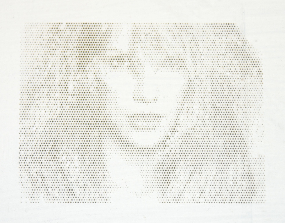

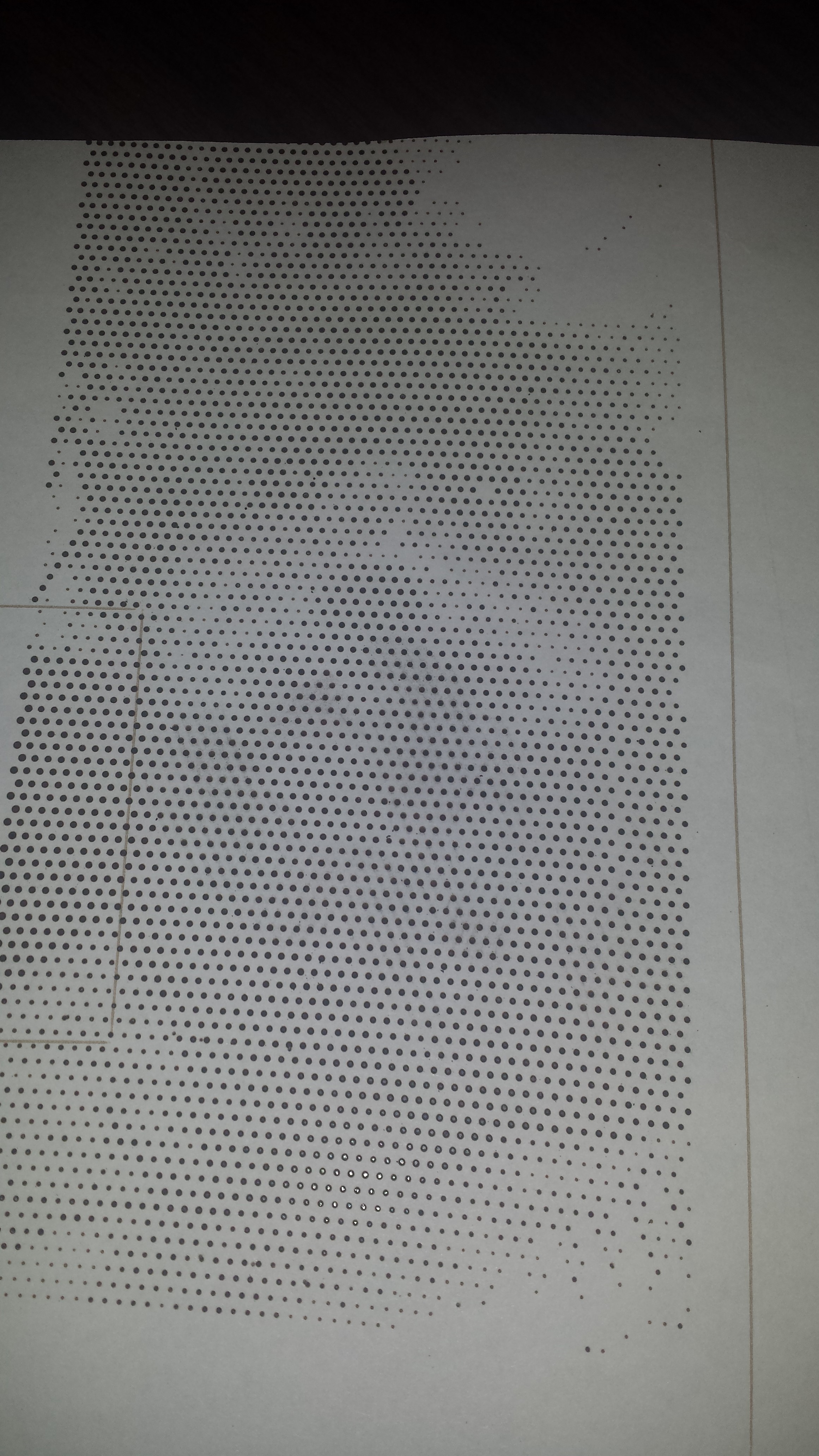

Tweak:
  Heres a photo for a power 30ms halftone on a 1.75 matrix done on paper
as a test. If you zoom in you can see the individual shot pattern.

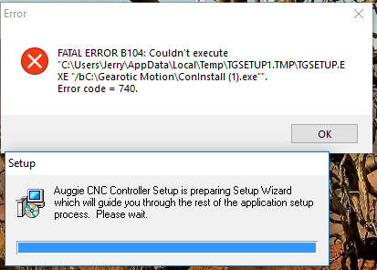

Re: Release April 1 / 2017 - Auggie
Post by Jerrywi »
Hi Art;
Just tried to update Auggie and keep getting this error message:
Any thoughts?
Jerry
Hi Jerry:
This seems to be a security measure on Win10, the install cannot be run from the browser. Copy the downloaded file to your desktop and it run, though youll have to select "more info" and Run anyway.
  I just tried this on my win10 machine and it runs that way, Im still investigating why that happens.
Jerrywi
Posts: 77
Joined: Fri Dec 07, 2012 10:36 am
Post by Jerrywi »
Thanks Art, That worked.
Jerry
