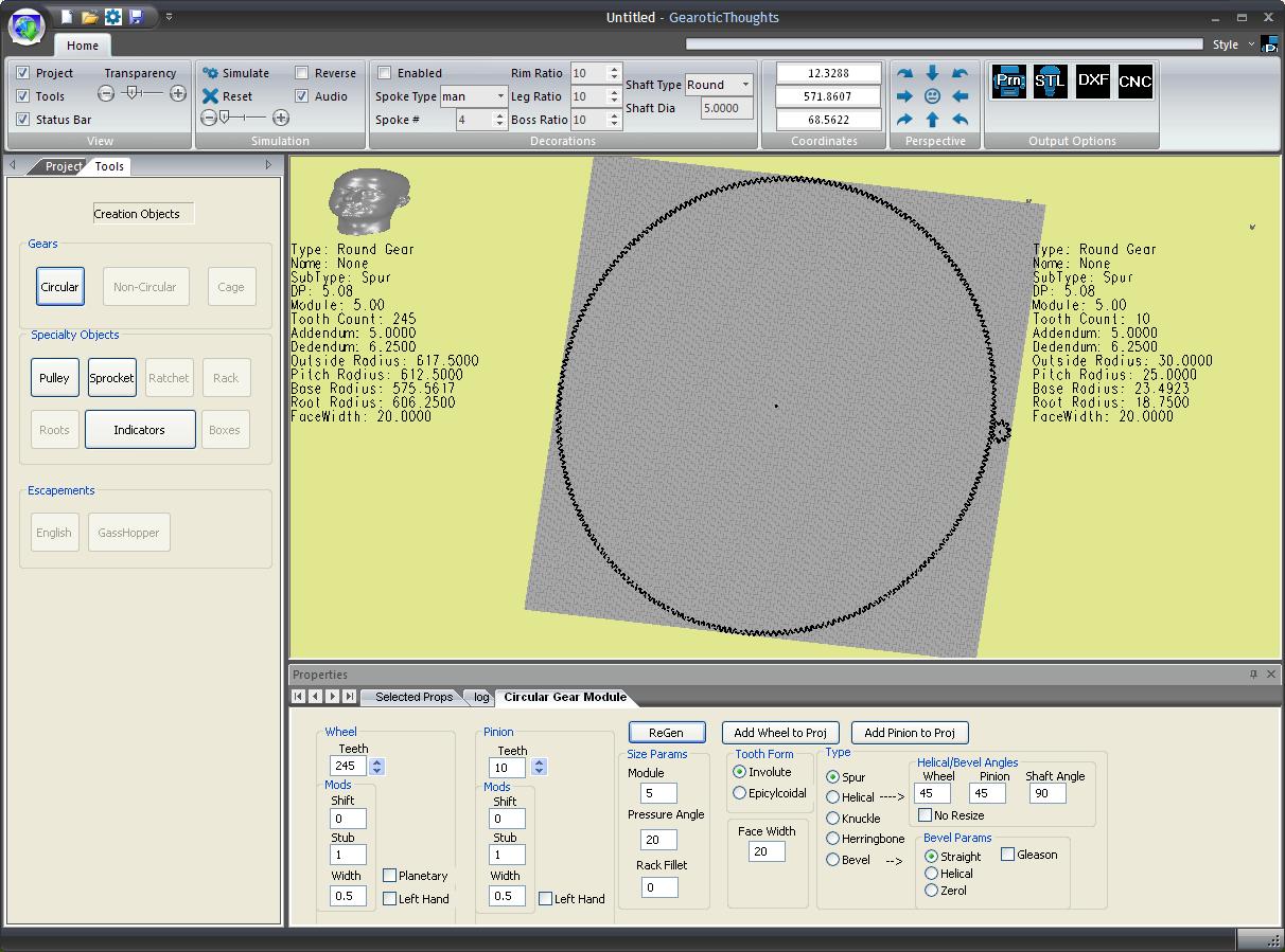

Might have to do with the number of teeth being too high. I am needing a gear for a heliostat drive that is four foot dia. and about 245 teeth. I used the spur gear that popped up when I click circular in tools. Is there a limit in GT or is it computer horse power? Thanks Dan
Re: New Release Version 4.90.02
Computer memory would be the limitation Id think, GT has no set limitations, it will try to create whatever one dictates..
Hi Dan;
Tried it here, seems to work for me using GT..

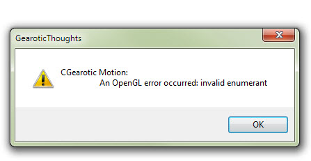

BOBL, I forgot to mention upon opening GT I get this notice. Dan
Hmm, that error usually indicates a video card driver thats old,..or a video card thats very old.
Does the program run after that error?

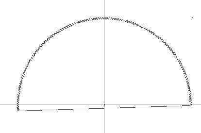

Dan;
I also encountered a problem when I tried to export your dxf, what I got was only half the gear... Weird.. Maybe Art can shed some light of perhaps why that is?
