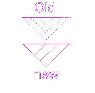

Version 2.23 is now online with corrections to the tool import and export. ( Tools now export as text files you can edit, you can also import them. These are an IO type of file,
the program maintains its own database format, but allows you to export a tool library as backup, or import one. If duplicates are found in naming , then the names are updated
with a copy number. So its always safe to import any tool table.
Taped and VBit tools are now profiling according to their class.. so be carefull of using tapers as the profiling will slowly move away from profile walls as the bit
moves deeper. This may sound wrong or seem wrong. My line of thought is that a vbit, is normally always under load on both tool flanks, but by shifting the path
to account for its taper on each pass , its load is shifted to a better position. It may be easier to handle the load on deeper profiles... but then I could be wrong,
it just seemed more elegant a solution which usually tells me its better.. :), I believe the load is actually identical per pass, but this should allow deeper total cuts.
I include a photo to show what I mean , the picture shows 3 passes with a VBit.. the old way and the new one..
