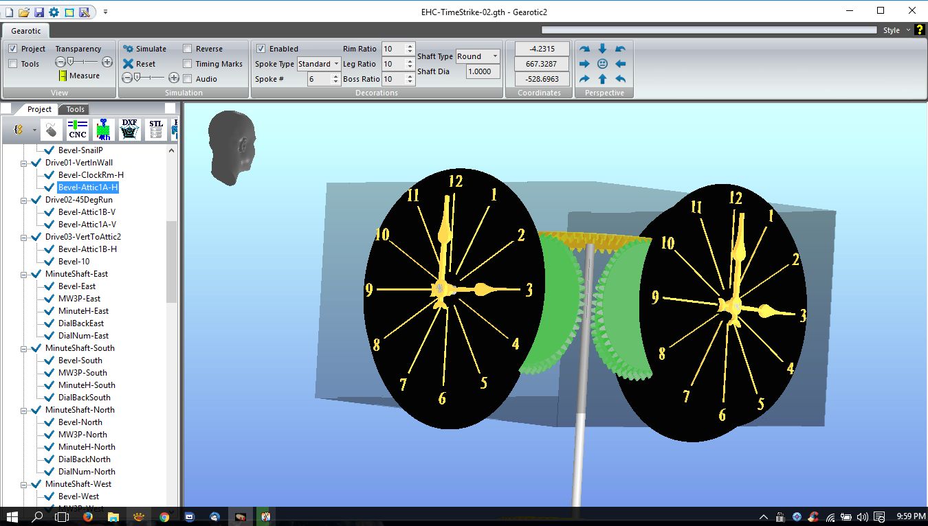

Thanks for the lastest update.  In addition to the mentioned fixes, this version has also cured the problems that I had mentioned in other topic areas with bevel gear reversals.  Now my sim of the E Howard Tower Clock is quite close to the real thing.
I'm now trying to figure out the protocols behind the scaling and placement of indicators.  I've created dxf's that create a numbered dial face for my simulation.
Initial orientation when placing the numbers seems to be random when placing the numbers on the output of a shaft (this is on the upper 4-way bevel gear split).  The way I've been doing so far is to figure out whether the shaft needs a forward or backward dial numbers, add it to a shaft, rotate it so the "12 O'clock" is vertical, & then remove the shaft-dial link so the number stays stationary when running the sim.
The technique seems to work most of the time and the one glitch I've run into I can not duplicate on a simpler simulation.  I will keep trying things until I discover whether the source is my model or a glitch.
Bill

Wow, you amaze me with what you accomplished,I didnt think one could make a sim look
that good in Gearotic. Youve really pressed its envelope, Good job...
Ill keep looking internally to see what I can make more stable. :)
I still spend time each week in Gearotic stabilizing and fixing small bugs.

I'm quite impressed with Gearotics ability to simulate clock mechanisms.
My experiments today involved playing around with links.  I had found a bug in my original Chronometer simulation that required recreating a gear pair and replacing the faulty spec'd gears that were located deep in the simulation. That ability to replace gears was much preferable than recreating the entire simulation.
I've also been experimenting with creating more realistic vanes for both the Chronometer and the tower clock sim & the brief movie shows one of my attempts.
Bill
Re: Version 2.3015 online
Wow!
  I stared at that foe a few minutes.. Amazing. I wrote Gearotic and havent
done anything that looks that good in sim. lol
Congratz..
