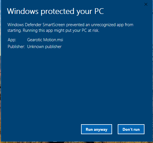

I ran the new download and received the attached warning.
I clicked "run anyway" and it downloaded the file, than windows defender wanted permission to run it.
The program was loaded on my desktop, but did not over wright the current copy.
Hope this helps
Jerry

Thanks Jerry:
Win10 is starting to give warnings over anything it doesnt recognise it seems.
The MSI probably didnt overwrite anythign as it didnt see anything different,
inlike the setup.exe installer which installs everything every time, this new one
is faster and only updates when it has to.
Thanks for the test
