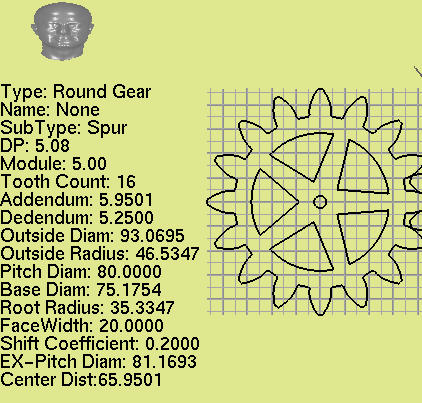

Font is a lot lot better.
However :) you have to diameter listed now as you said you would but pitch circle is still in radii.
Also in GM if you shift a gear you get the ex-pitch diameter listed, not so in GT you get shift coefficient listed which is showing in the box anyway.
I have been playing with 2 gears today a 125T and 127 and because of design limitations I have to make these identical even though they are 2 teeth different.
Far easier to do in GM than GT. and the printed results in diameters are more meaningful.

Re: New Version 4.93.03
Hi :
Thanks for the font reports, sounds as if their getting better now.
Ill swap the pitch to diam, and see about the ex-pitch on shifted coef.. I hadnt spent much time in there,
it was mostly just getting the control code done, Ill slowly be changing the actual displayed data to whatever
people find usefull, trivial now that the code is complete.
In future will be as shown before. ( Unless people want other data added. )
In this version, since you can see EX-Pitch and such, the difference between GM's
coeff shift and GT's becomes apparent as the numbers differ quite a bit. GT's are
the correct figures. :)

OK, fixed up those so that LH/RH is correct ( in my world of logic its CCW and CW so I sometimes
get them backwards. :) )
Also, I fixed it up so only the tool that NEEDs to be closed to stop inadvertant crashing close, so now
if you delete a gear you can still tab into the gear window to create another without reselecting that tool.
( I do find this works better..thx for that bug..)
I also added more text in the involute text to show the pressure angle, the extended pressure angle if shifting
is also displayed. This sections worries me as the differences between GM and GT are quite large. If you
for example do a profile shift of .5 on the wheel and -.5 on the pinion, the result is no change on the
pitch diameter on either gear. I had to triple check this as it sounds wrong.. but the formulas are
pretty insistant on that point, they do not consider profile shift to be a 1 gear calculation, both gears are
included and cancel each other out, but do increase the outside radius. ( which to me implies a new pitch radius..
but apparently not ...or we're into bad formula's published again.. ). We'll see I guess...

>>Anyone know where I can get a 44.53 DP gear cutter ?
I guess you could use the dxf of the involute profile to make a cutter
or we could start the discussion of how the heck I can do it for you from the dxf profile. GM's cutter maker didnt work
great , so I think we have to figure out the best GCode method of creating a cutter.. Ive made sure GT has the data
to create it, just a question now as to how best to do it..
(Gears look good though.. good 3d printer, eh?)
>>Only way i can get it to do it and loose e the gear thats now written in stone in the project screen is to exit the program and start again.
You can press the "new project" icon ( top left of bar), OR select the gear by mouse on screen or project tree, and then press
delete on the properties tab. The first will get rid of all objects, the second just gets rid of one.
>>Now how do I get back to that gear to make more alteratio ns for a second gear.
You use the Redesign button...( not yet implemented, should be out fairly soon though..)... :)
