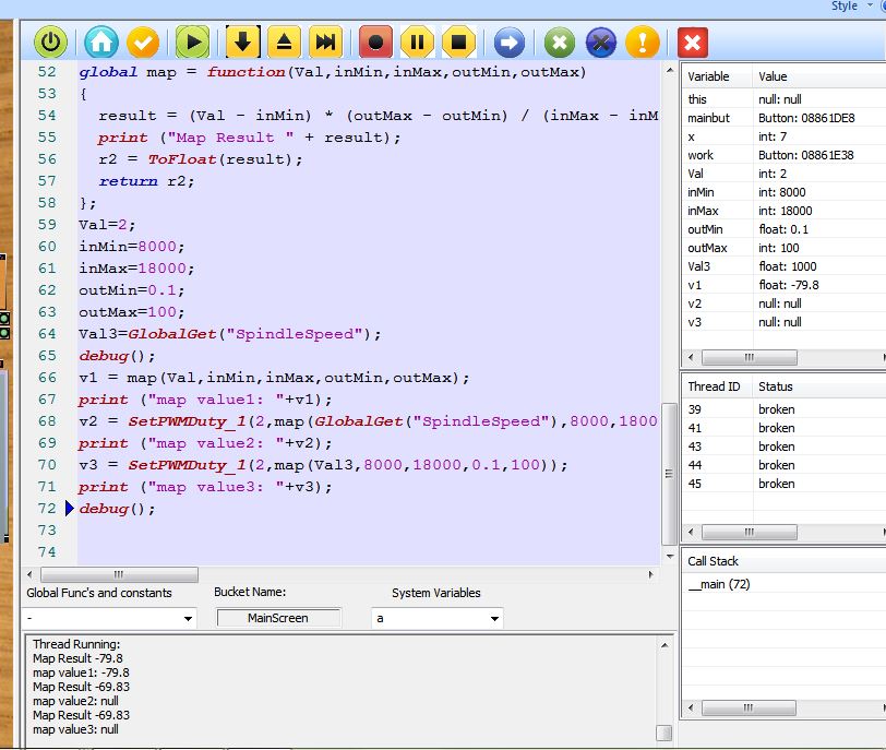

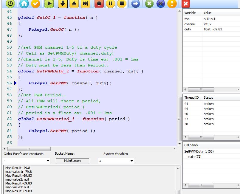

I find the best way is to open the script editor then the mainscreen script, then i can step thru and see the actions.
I create some test routines to pass the data and see what is being processed.
shows me that there is no return value to be passed back from the function.
but I might be missing something you are expecting to see.

v1 = map(Val,inMin,inMax,outMin,outMax);
print ("map value1: "+v1);
v2 = SetPWMDuty_1(2,map(GlobalGet("SpindleSpeed"),8000,18000,0.1,100));
print ("map value2: "+v2);
v3 = SetPWMDuty_1(2,map(Val3,8000,18000,0.1,100));
print ("map value3: "+v3);
debug();
debug();

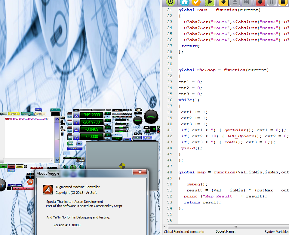

Art
Thank you for the video.
Saw some other stuff I didn't know about though.  Zooming of the screen. :)
I had 1.1 still so the debug() wasn't working.
I thought I had updated last night but guess not.
YNN thank you for the tip.
I post this routine in the shared scripts with some things that might help people later.
Fun stuff..
Glenn

[s]Ok I just down loaded the latest off of the web and it still shows 1.1 and even with the debug in there it isn't dropping into the scripter to step through.
I know it updated the script files since I have to add everything back in.
Really need to copy that directory.[/s]
I wonder if I have something else wrong.
Glenn
Edit: I did there was one Auggie hung open, when I looked in the task manager.
So it couldn't over write the existing file.  ::)

YNN
Sorry about that missed that you weren't getting a value.
Change out the inMin to something less than the spindle value that is getting passed.
So put in 0 to start instead of 8000.
Looks like we need to test the value first to make sure it is more than what the inMin is.
Glenn
