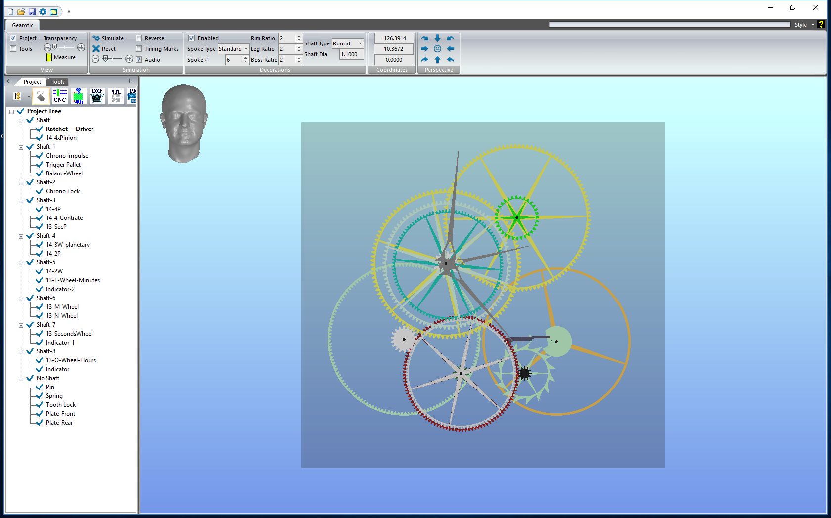

Attached are some screen captures of my Try-6 attempt to model an existing chronometer.  The escapement is one of your standard ones.  The real one uses a 15-tooth crown wheel that would be at right angle to the "contrate" wheel.
I don't have much time tonight to add much more description.  I used XNVIEW to perform the screen captures because the Snapshot and REC do not work properly on either of my Windows10 systems.
If I have time, I can try to take a video of the model later this week using my digital camera.
