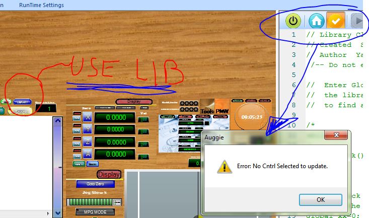

Art I have run into a problem, with glens help and me not reading what you said as do in that library,my bad I have done another library for the superpid just using the code out of the spindle relay only, and putting the changes what you said to do in it, I compile it comes up with no issues then I run it no problem's then when I go to check it back in it comes up with, no cntr Selected to update.
here is what I did
here is what I did

Did you use the "Lib" dialog box to check the script back in with. If you check it out with the Lib, you need to check in back in with the "Lib" dialog. Same with the the debugger checkout.
Maynard
Maynard

You can check in a library only if its a complete library file, it must have the name header and such in it. So
create a new library first, then check it out. Modify it with your code, and then check it in .

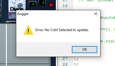

I cant find a message "no cntr Selected to update" in the program, can you check and see exactly what the message
is and Ill tell you why it occurs. It sounds as if your very close but are missing some syntax or routine, let
me know what youre getting and we'll trace it. Ill be away this morning, but this afternoon Ill write a description
of what may be happening..

It's what you get if you open a library in the scriptor, and try to check it back in via the check box on the scripting toolbar. :)

Yes I had noticed that too if I used one of the three buttons.
But the place to check them back in is under the Library button, same dialog screen you checked them out with.

There are 2 classes of scripts. Screen Scripts, and Library scripts. You check in the library scripts by using the LIB
button only. Ill explain that better in a future video. :)

that was the problem thank you gents, now to see if it works.
