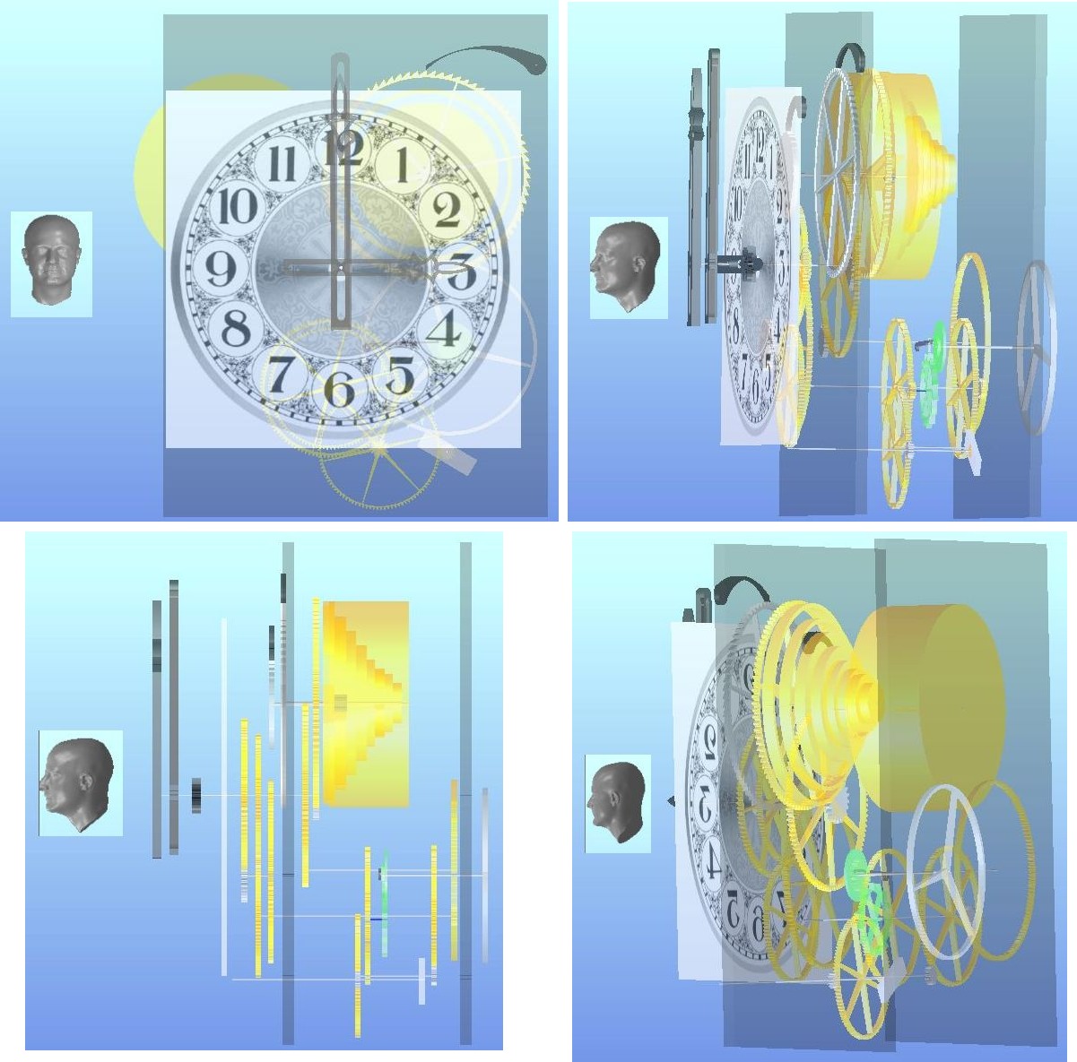

I think I've gone as far as I can at this time to make the chronometer simulation.  The attached files are snapshots and a video of the simulated chronometer that is named ChronoSim-02.gth.  Aside from the recoil escapement instead of the correct verge escapement the "looks" of the chronometer simulation seems about right.

  I have to say that is the best simulation I have ever seen done in Gearotic, it wipes the floor with any I have done.
Fantastic work. ..

It made me laugh Bill, because that sim was the best Ive ever seen, including my own.. :)
