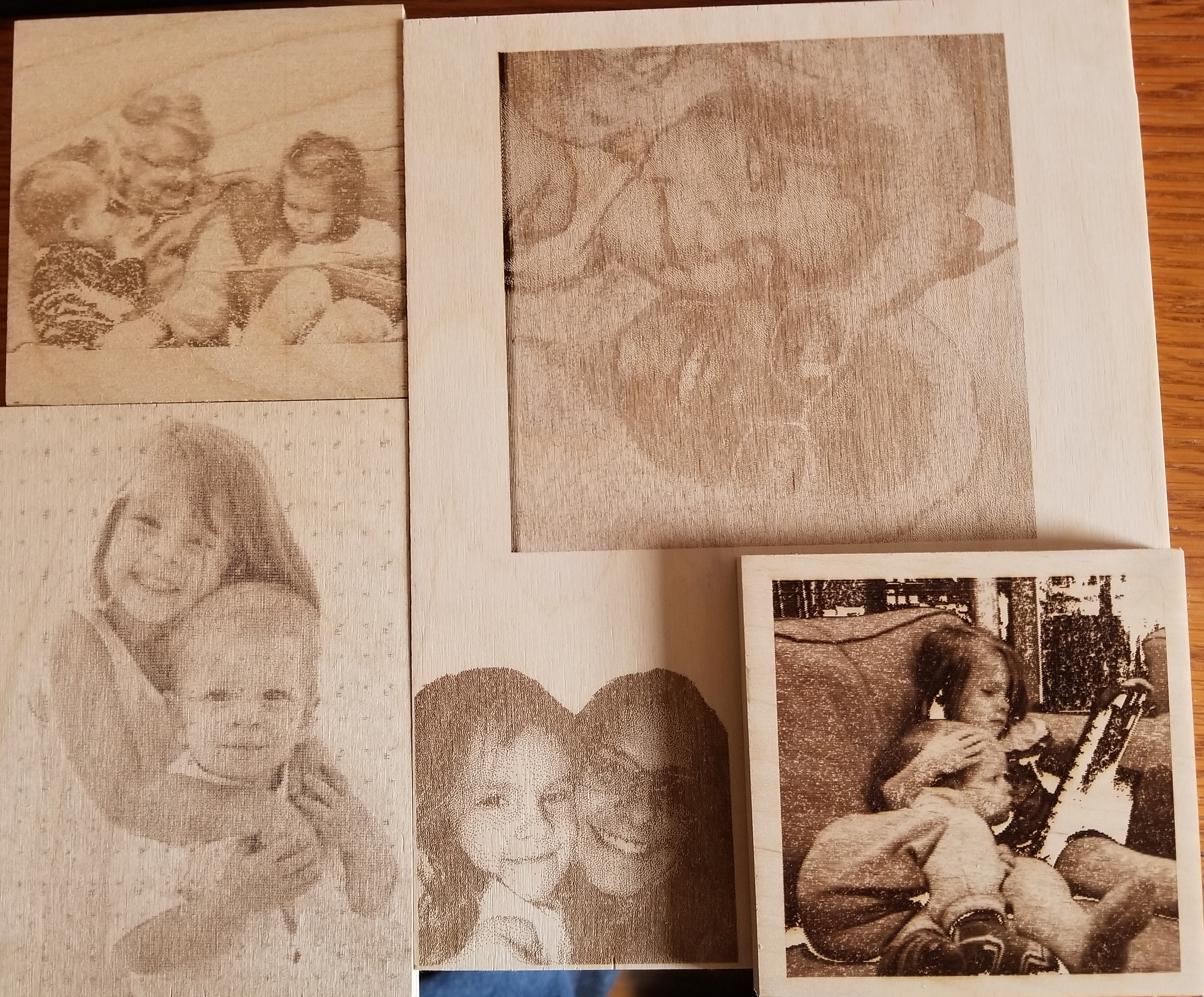

I have been fiddling around with a 10W diode laser mounted to an old 3 axis circuit board prober. I replaced the original electronics and kept the frame, linear rails, steppers, proximity switches and etc. I used an old Xylotec board gathering dust in the drawer from bygone days. Work envelope is 11"x 13".
My first adventure in CNC was using Mach3 on a home build router with a work envelope of 30"x40" but have since migrated to Linuxcnc. I have retrofitted metal working machines to CNC using LinuxCNC.
So my laser setup now is working adequately for vector engraving but my goal is to do raster engraving. I can do it but it is very slow and tends to burn for reasons that Art developed Auggie. Sometimes Gcode isn't enough. I have used M62/M65 to initiate the laser on/off coordinated with motion. Not good enough. I started down the path to induce a variable delay in the firing of the laser to accommodate for the accel/decel. Had not finished that experiment before I was pointed towards Auggie by a friend of mine. Setting up post processors to accommodate my particular setup is tedious so....
Before I step out and replace my current set up with Auggie and a Pokeys board, I'd like to set my performance expectations. I suspect Auggie will drastically enhance my speed and quality to produce a photo image on wood but would like to understand what you are experiencing. What kinds of elapsed time do you guys see for a 5"x5" photo? What kinds of pix/in are you typically using?
I'm very much a novice at this laser stuff so I'm sure I will have more questions for this forum that will arise especially if/when I convert to Auggie.

Art, good info. Now let me play it back to see if I really understand.
My "system" (imaging app and postprocessor app) now codes a 0.008" move at max vel (246ipm) and power level. Then it moves another 0.008" at max vel but at essentially 0 power (.1%). Repeat until done. So the effective velocity is and nowhere near 200ipm. I've never measured/calculated the effective velocity given the processing delays, accell and decell. I can tell you that I recently engraved a 5x5 and it took well over 4 hours so 30 minutes sounds like heaven. Pretty tough to get a handle on all of the raster engraving variables (image edits, resolution, dither vs. grayscale et al) when it takes 4 hours to see the results.
I think you are saying that the time to engrave using Auggie would be more related to my laser power available than machine velocity. Is that because the script file handles the power changes as a coordinated move with the axis(s) in motion (linear, spiral whatever)? So my motion would be at (closer to) the true programmed velocity. Right now I'm limited by the effective velocity of the extremely short moves and the related accel/decell. I haven't even seen the 10W diode as the limiting factor. In fact, in baltic birch I am running at about 20% power to prevent burning at my effective feed rate. With Auggie at my max velocity it would take 1.2s to traverse 5". If the 10W is enough power for effective burning at 246ipm then it should take about 14 mins to engrave the image.
My laser power level is PWM controlled. Right now I have the frequency set at 100Hz and a power range selectable between 0 and 1200. Probably too much and unnecessary power range but that's easily changed in my HAL file. I just haven't experimented with that yet. And yes, I can set the max power to be used in the image/postprocesser to whatever I think appropriate for the material used.
To migrate to Auggie, I think I would have to get the Pokeys57cnc board and 3 stepper drives since the xylotec breakout has the drives integrated. From what I have read I think that is about all.
Then I ask myself, why not change my Mach3 router (smoothstepper and C11 board) out with the Pokeys board and put the Laser right on the machine with a larger work envelope and a 4th axis. Mach3 (still) for the router. Auggie for the laser. Same computer. Same physical platform.
Then I think about using the extra rails, ball screws and materials I have hanging around and just make a dedicated larger laser pedal my current "little laser learning" platform.
My head hurts. I have decisions to make. Wish me luck.
