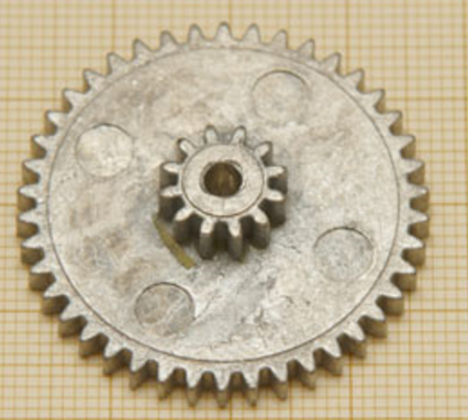

I have physical gears that are manufactured as a one piece, for example, a 42 tooth and a 12 tooth gear.
To simulate, I can stack two gears on a common shaft and link the shafts.
How can I link the two gears together without linking using the shaft.  I have other sets of similar gears on the same shaft.
It is for a gear box.

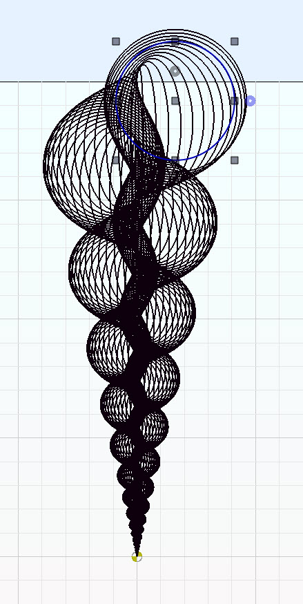

Bertho:
  Sample of what my version of a shell maker looks like. :)

Neat!
You always come up with interesting and amazing programs.
Have a great weekend.
