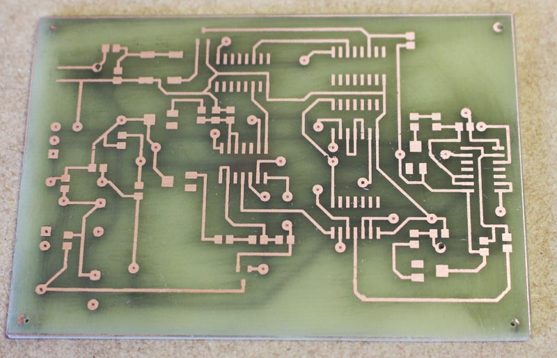

Re the clock: I've designed and made the printed circuit board but have to wait for a new hot air bit for my gas soldering iron to arrive in the post before I can finish assembling it. It's a surface mount design (I can't stand drilling all those holes!!) so the conventional iron doesn't work too well. I have sorted out which bit's of wood I'm using for the wheels though and am finishing the design of the base now I know the size of the circuit board.

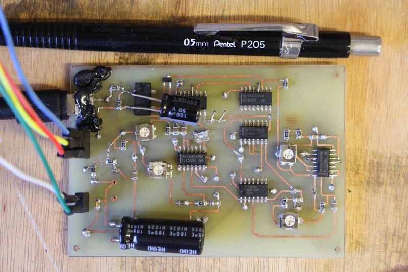

A bit more progress on the clock. The circuit board was designed using 'DipTrace' software and printed using the DIY favourite 'toner-transfer' method. Soldering is completed and it is now sucessfully driving the prototype mechanism powered by a standard USB wall wart. That was a key aim so I'm very pleased. As you can see from the pictures below, a few mods were required to get everything working correctly so the finished board is not quite as profesional looking as we might wish.
