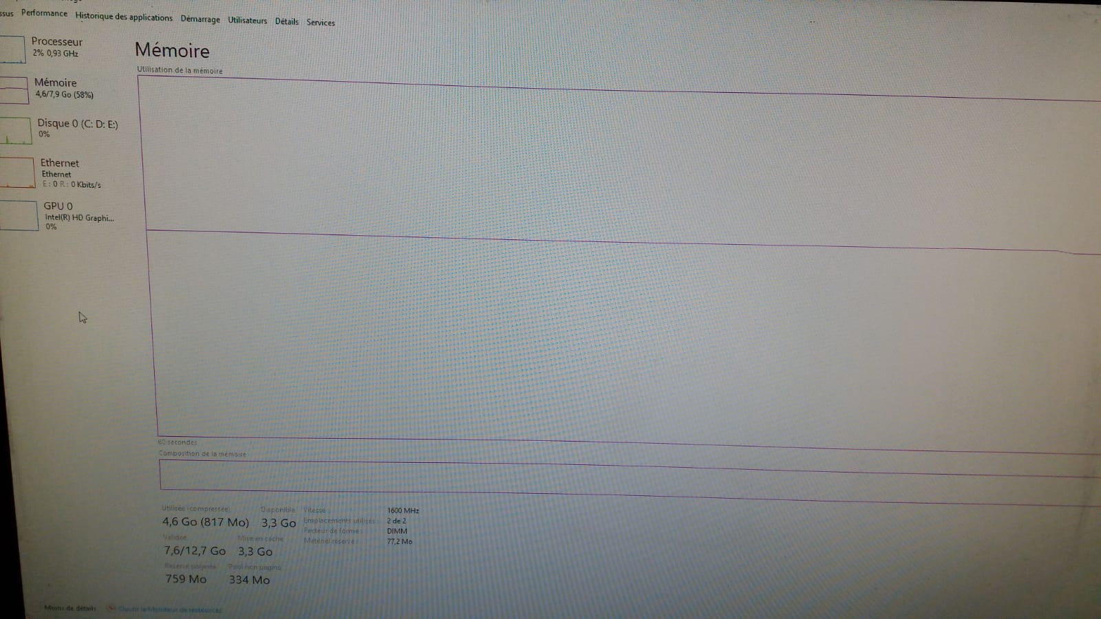

So , is in RAM loaded. I understand why i got some errors on old one , and was 8gb/ram not 4 , i forgot , but like you see in picture attached , only opera browser loaded and one PLC compiler , let me only with 3gb/free .Roman wrote: could be as I 'drive' on the bare minimum on an old Shuttle barebone which I use for the CNC machine and which only has 3GB. It is quite old but was 100% sufficient so far. After booting W10 puls Norton allone consume about 1.5GB physical.
On second one i never got any error , only when i made some :-[
