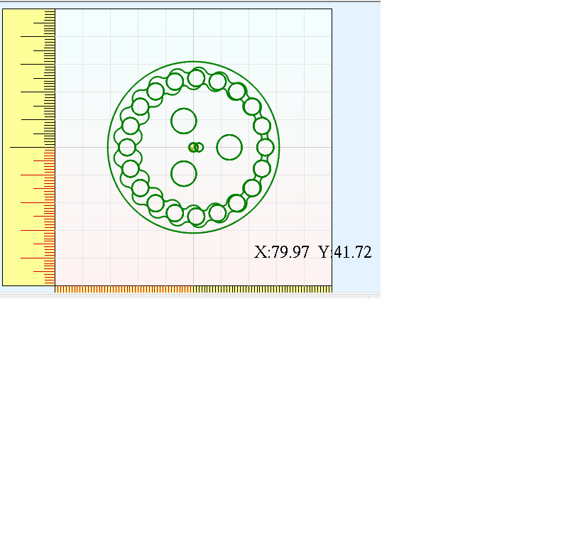

Hi Tweaky:
It was just released in Vexx, I just havent yet made a video on the topic. :)
Youll find a new button on the vex tools that calls up the cycloidic reducer tab.

Each f the components, when generated, are grouped as to function. So, if you select just the
rotor for example, you shoudl be able to select "extrude" in the tools and extrude just the rotor
to an stl.
I havent tested there at all, Im still finalizing that module... Let me know how it works out. :)
to an stl.

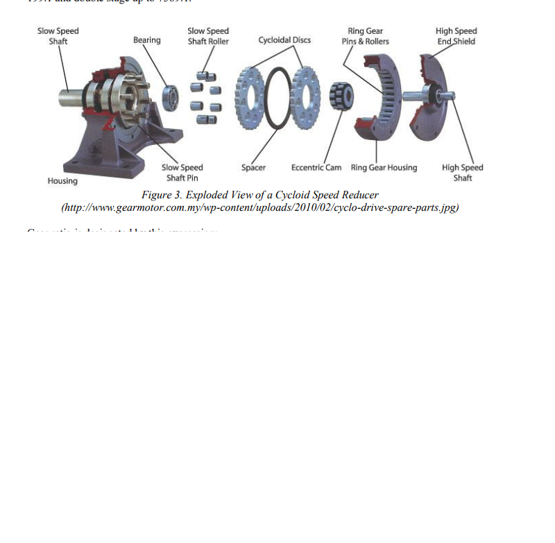

With some random giggling I came up with this page which among other things included the attached picture that gives names (at least their names) for the parts.
The pic shows a high speed shaft that looks a lot like a cage gear (although iirc the stl has bad pins), just leaving the low speed shaft and the way it connects to the ring gear. Do you have any plans to add something like these, or the parts in Tweakie's gif?

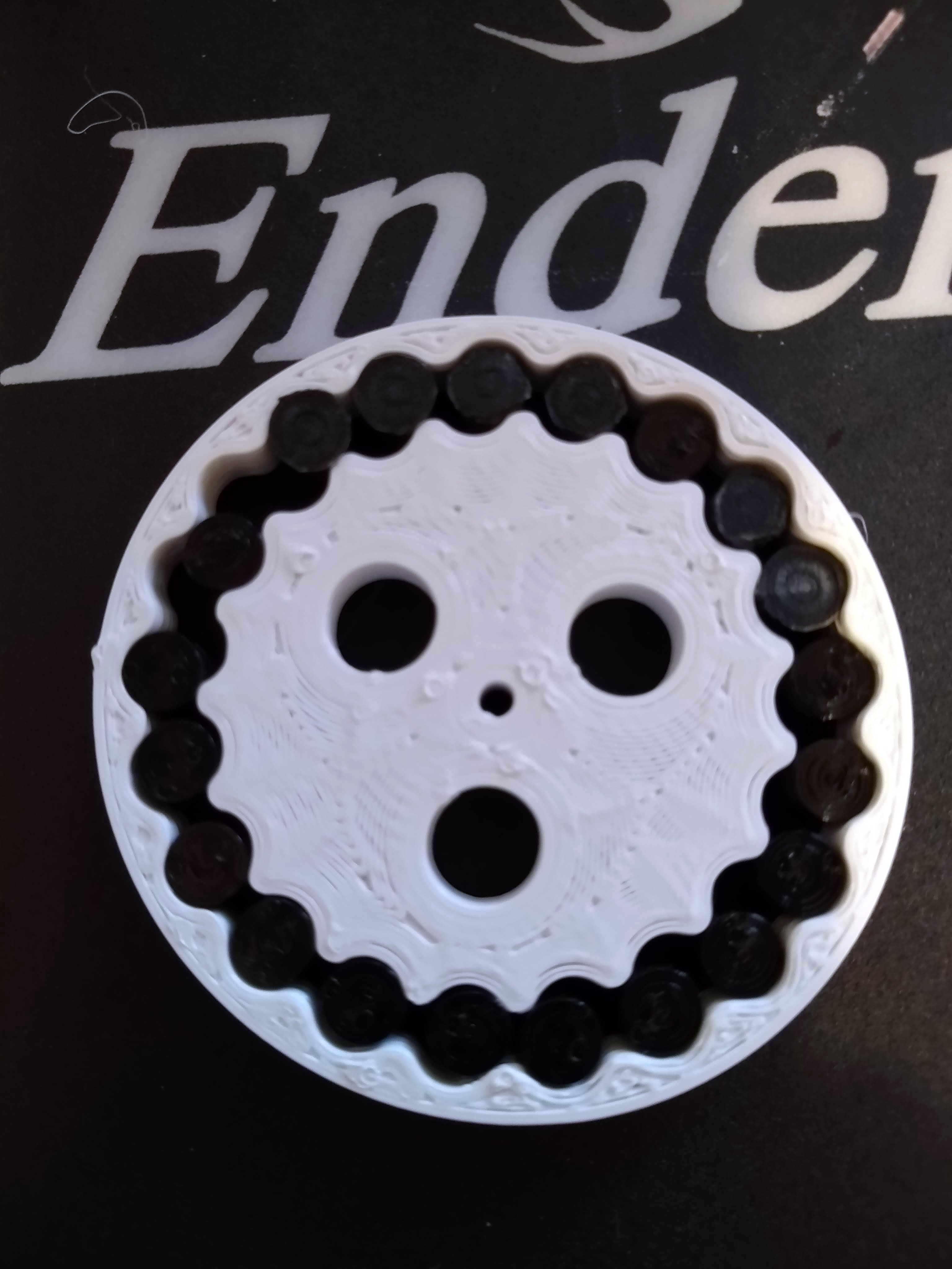

The cycloidal disk and ring gear printed OK, although I really should take the time to properly get this new ender 3 pro printer properly set up, particularly as my regular chair sitting time is slowly increasing. Black 6mm pins are printing as I type this, will either post a photo or pretend it never happened depending on the results :)

My camera thought it was a face :)
The pins are oversize, 6.2 instead of 6.0mm so it's hard to turn, but turned out pretty decent.
