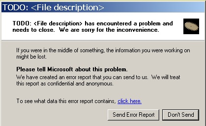

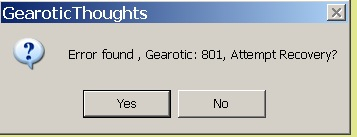

The previous version opened for me but not this one or at least as soon as I try to put something on the project screen I get these errors.
These dialogues appear in order as I try and go deeper into the problem.

Hmm, must be some divide by zero somewhere. Unfortunately the program saves almost every setting you make and if one is causing the
trouble it may be a bit hard for me to find..
Can you run Regedit? If so , delete the entire registry entry labeled
HKEY_CURRENT_USER/Software/Gearotic Thoughts. That will reset all the remembered
itesm taking you back to default. If you can do this can you tell me if it now runs?
(Sorry for all the bugs, its actually normal with such drastic changes, I expect stability to be restored fairly quickly
as I track these down..)

Thx John:
In the meantime Ill add more error codes in the 800 block so we can figure out what
exactly is causing the error.

I finally got in a position where I could follow your instructions. Everything now works the way it should. Having fun.
