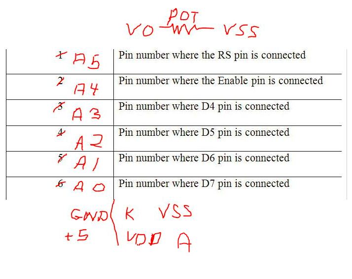

I am a bit confused about the pins you have set I am going to be using a Leonardo, I am not sure what pins to use for the lcd screen you have it down as A0-A6 is A6 digital pins 4.
all the other pins I can understand I will just use the one on the plan you did for what pins to use.
it will be 3-4 weeks before the parts show up so everything will probably change by then.
I have not change over to a Ti board yet as it will take a bit of recoding to get working as the way they do pwm is a bit different from arduino it will happen one day.

Got this from line 50
//initialize the lcd..its on a0-a6 lines in my leonardo..
this is what worked for me.
Not pretty as I can not seem to write well with a mouse. ;D
I added the pot to control the contrast

char bro I don't mind waiting at all it will be a few weeks before all the parts show up
Thx Guys:
  Yes, those seem correct as numbers. ( Preciate it ). The call to LCDInit shows the numbers
I used and what controls them. The line in the code for
LiquidCrystal  lcd( 23,22,21,20,19,18);
shows the init of the lcd and its settings as to pin. So looking at the call above... the pins in order are
RS pin -- 23
Enable -- 22
D4 - D7 pins 21,20,19,18
  These pin numbers correspond to A5 - A0 on the Leonardo..I suspect the pin numbering differs because
the library wasnt originally written for a leonardo so at the time I traced them by schematic as I recall..
If anyone has trouble with that usage let me know and Ill tear mine down to double check it, but I think
YaNvrNo has it right..
  Schematic has been corrected as to pushbutton wiring ... the post at
http://gearotic.com/ESW/FavIcons/http:/ ... 7232#p7232
has been updated to show the fixes.

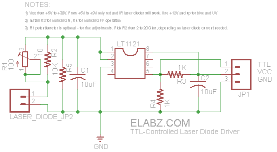

morning all I need some advice about what to use for a drive for a laser I will be using this is it
http://www.ebay.com/itm/2W-445nm-M140-B ... 2a2158fe9d
its a 2w 445nm Diode laser I will be running it at 2A 4.7vdc. what I need is advice on what to drive it with there is lot of info on driving a laser with a LT1121.
I Have a Schematic for it see attachment I know it is only for up to 1.5A I can get a bigger chip 2A+ for it is this schematic good enough to run with your controller art.
also I have striped back the sketch so it only has the Laser control stuff on it can someone have a look and see if I got it correct as I don't have all the parts yet so cant test it.I have disabled the LCD part as I am porting it over to run on a TI board

Hi DanL:
&nbsp; Wow, nice diode. Being blue it could also harden oxalic acid infused fibreglass resin ... nice thing to play with..
&nbsp; Schematic looks like it could be used, take not of just how important cooling is with such devices, I have a few lower
power ones that I run for small periods at times and cooling is really very very important as you get up to 2 watts. A blue 2 watt is quite powerfull really, be interesting to see how you make out..
Id change the line in the code at
pwmWrite( PulsePin, 8); //set for 1us for laser tickle
&nbsp; to 0, as you dont want 1us tickles, you want 0us as a tickle and only want the
PWM to be on when the laser is. Set the variable OneMicro to 0 as well, it defines the PWM timer's
one microsecond setting. That will then make the laser only fire when given a power from Dariwn greater
than 0%. Probably take some fudging about in the rest of the code but those two changes should
make it run as youd expect, making the PWM really into a TTL trigger in PWM form..
&nbsp; Ill be interested in how you make out, feel free to ask questions if you run into trouble
as you test. Hard to say without testing what trouble youll run into , youll probably want
to use some sort of console messaging for feedback to tell you whats up during testing...
