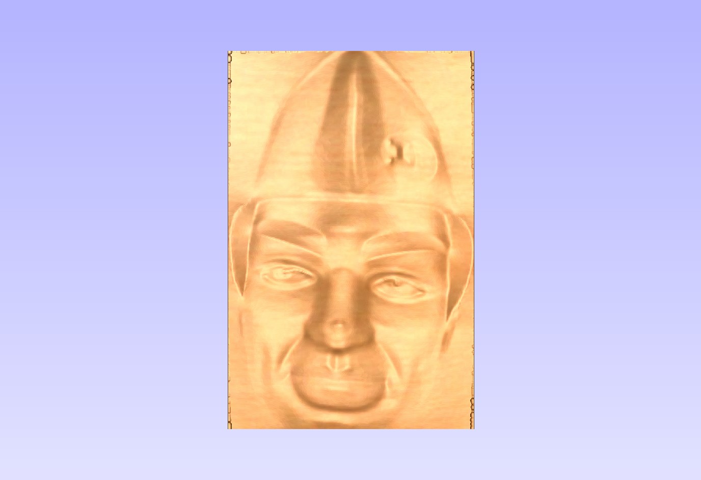

here is a pick done with my webcam sitting on my laptop I have background lights on so its not the best but it half the depth of doing it in my scanner box with the Gradient scale at 3

Also, look closely at the images, any chance the timing is off on the scanner box? The photo is actually taken at the end of the flash cycle, not at the beginning. When the screen flashes the one side, you have
to be pretty carefull about when exactly that photo is taken.
I guess I really need to put out a trigger just in case for people like yourself that can use external
processes.. But your right, it could just be your images are too good.. Of course, you dont need to use Gearotic at all for taking of the pictures, so long as you save them in alphabetical order so the
reconstruction knows which is which..
In the fall when I revisit the 3dfromwebcam, Ill get some images from you and analyse why
their so strong. Ive moved on to a new investigation now that will keep me busy till the fall,
so we'll discuss this in more detail then. The new 3d will be released than as well.

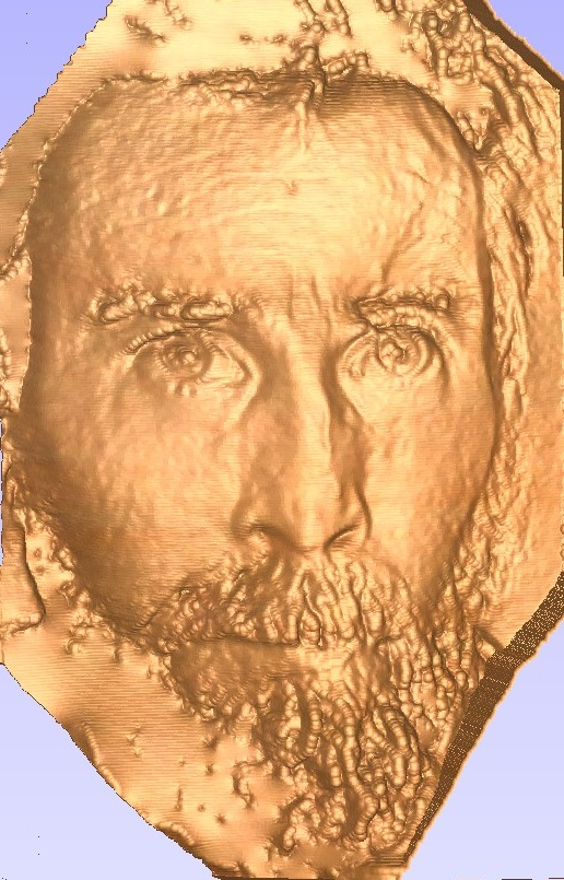

hi art I have gone back to the dev version of gearotic I could not get anything useful out of the version you sent me with out being 100 mm plus deep I played for quite a long time everything I tried somethings helped some not.
I think the problem is the webcam I am using compered to what you have mines a Genius FaceCam 1020.
I have it set to 640 x 480 YUY2
250ms
Confidence is around 100
Gradient Scale 1.50
pedestal closure ticked (what ever it for)
pick attached I got a new program for the web cam I have and can zoom in and pan with it.
so it is better than any other program for scanning I have now
250ms
Gradient Scale 1.50

If you get a chance, could you zip up a 4set of shots saved from the screen? Id like to
experiment with your data in the new code. Pulling out too far is an odd one.. Id like to see
if I can make any adjustments to allow a camera such as yours to me a bit more muted
for the release of the new code in the fall..
