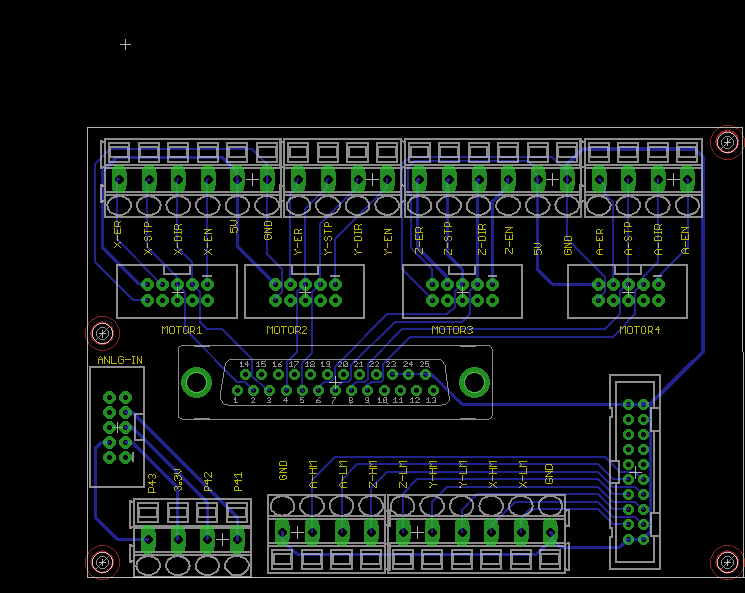

Which pin are you using for the PWM output?
Looking at it pin 22 looks like the most logical.
Just making sure.
Glenn

Glen:
Unknown as yet, motion is done, but IO is yet to be implemented..next few weeks will tell...

Thanks for the reply.
Look like with the free eagle i am out of room anyway, so will have to be a second board.
I should have the gantry moving on Wednesday, yea for vacation time.
Still not sure if i am going to run my G540 or the Chinese stepper drives, hence the configuration.
Glenn
