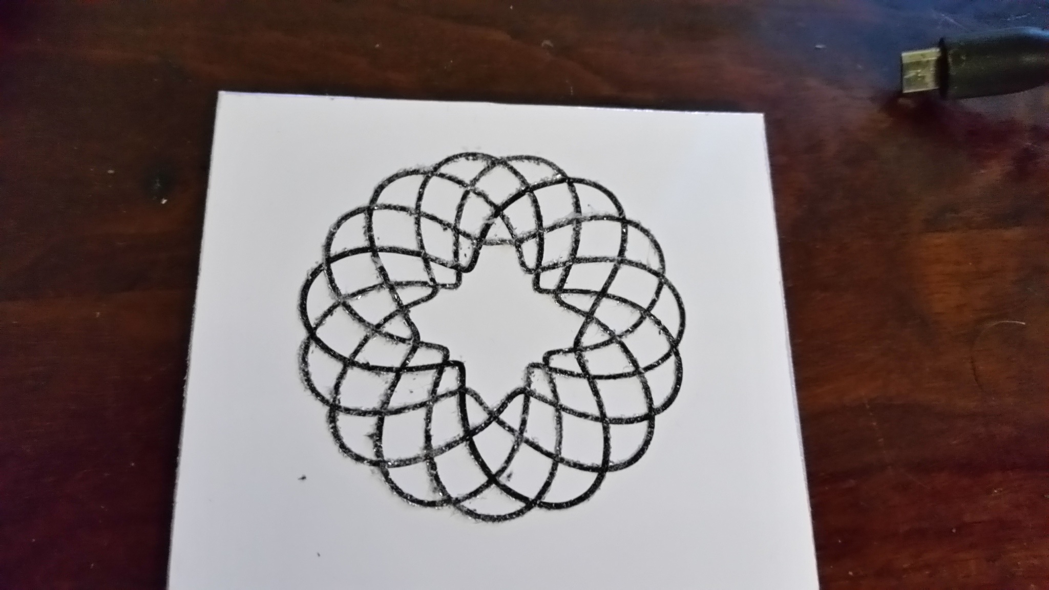

Cant give you much on technique or bits, Ive been using laser for my testing..
Re: Guilloche!
Hopefully the 90 degree v bit will come in the mail tomorrow, then. Thanks, Art!

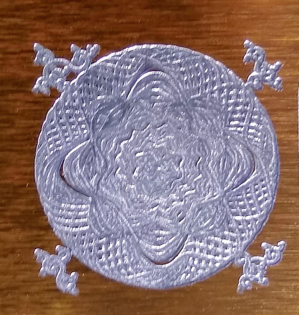

i just tried a guiloche on a scrap piece of flammable building cladding .
[platicised rocket fuel sandwiched between two aluminium sheet with a uv plastic exterior coating, think granville tower]
might be a better use for the stuff other than making high rise roman candles.
this scrap was a bit damaged and the camera flash shows every defect nicely
made with aforementioned springy engraver tool [3040 mill @20000 rpm 1000 mm/minute]
needed a couple of passes due to surface dints. the edges have very little burring

that was the first time i have experimented with it , my first thought was wow this stuff would be excellent for signs/instrument panels etcIs that the aluminum/plastic/aluminum sandwich board the signmakers like.
so it probably the same stuff.
just need to figure a way to remove the al chips [caustic bath may work]
i have had it for several years it was the ball screw version , since upgraded to usb,vfd spindle. pokeysRichard, how do you like that 3040? Is it the parallel port or USB version?
as it was delivered the x axis was not parallel to the table ,it needed some work to true it up.
the z axis is now showing some backlash that will need attention. overall its held up well and made lots of chips
i dug in a bit deeper here completely through al layer

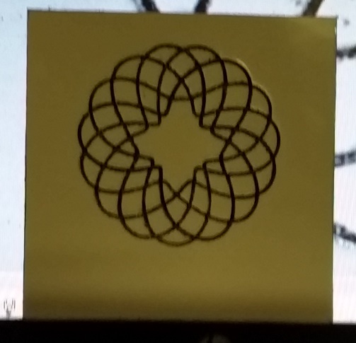

A drop of tapmagic self-distributed (sprayed everywhere) but it spread out nicely with a little finger wiping. Today's effort was at 0.05mm with the 90 degree bit, planned to do another copy at 0.1mm but between the shelter trip (will be taking the moosedog next time, after we get a copy of his immunization records from up north) and taking Mrs. Moose to dinner have run out of time.
The outer pattern came out well, more chiseled looking in person if not the video. No burrs on the edges at 100mm/sec, might boost the next test up to 200 (yes, I know, shouldn't change two parameters at a time). The center was too much detail and washed out, will see if deeper makes it better
Edit, thought the lighting and focus came out better, guess not. Need to figure out how to photograph these properly since they look much nicer in person. There's a flourish in each corner, but they didn't turn out real well at this cutting depth

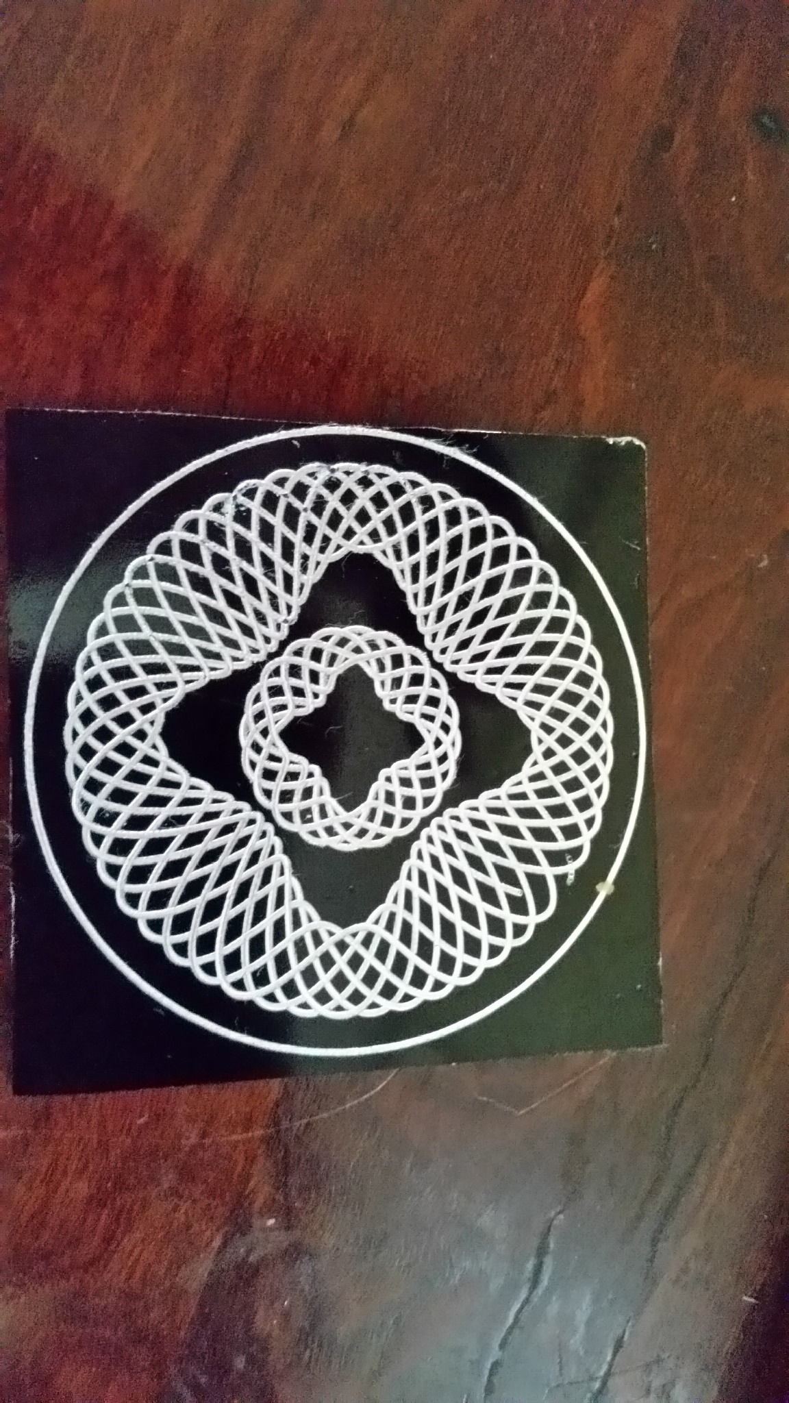

Got a chance to try again, 0.1mm and 200mm/min. Overall I think the first (top in the picture) looks better but it's close. The center is still wiped out, past the limit that this bit/machine/material will do. Vexx was still open so I screenshotted the actual design for comparison.
