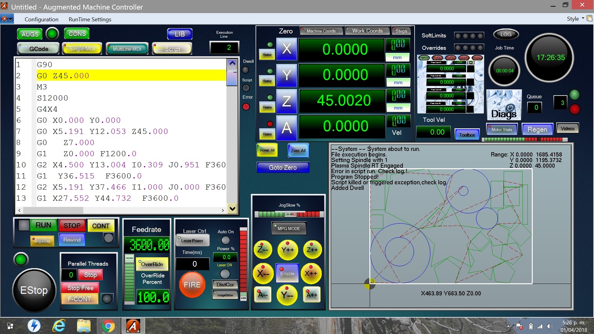

Good night, a question my auggie does not activate the spindle with the M3 code. Should I add it?

yes sir, I have it activated but when I load the code g and start doing the movement, it locks up when it finds the M3 code. and create a new script only with the option to turn on and off plasma with relay # 3 and it does not work either. Here I leave you the scrip that you wrote and the error that appears when the machine finds the M3

Re: Script/GCode interface
The messages seem to show the script being called, can you press the log button at that point and send me a copy of the log? Does an ESTOP happen when you do this or does the spindle just not come on?
yes sir I did the test and the relay is turned on with: Pokeys1.SetRelay (3,1); and it shuts down with Pokeys1.SetRelay (3,0); .
When I run the G code when I reach the M3, the program turns on the N (3) relay and the system locks and the error LED on the screen turns on. Annex image of the error.
I appreciate your help.

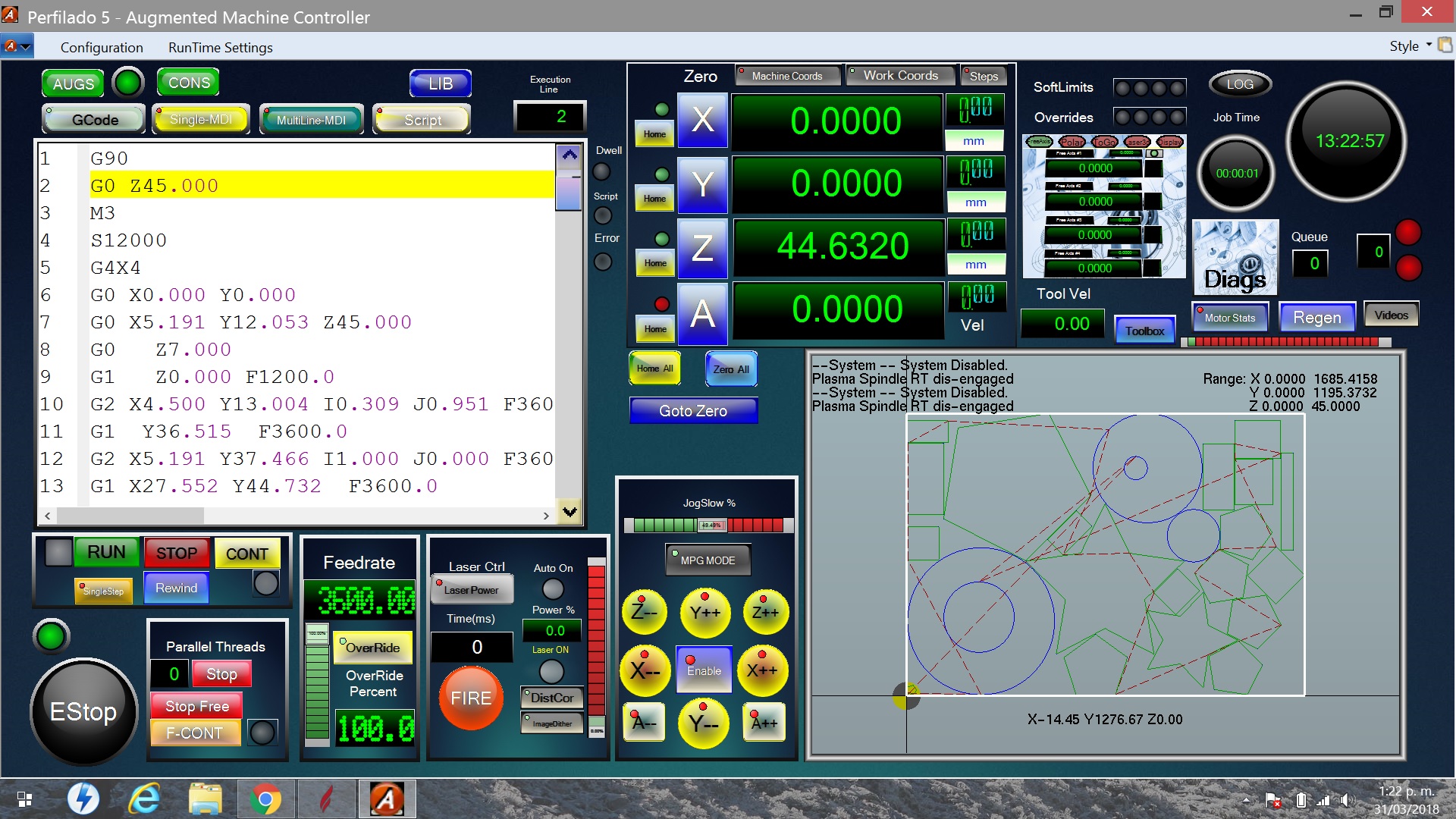

It sounds like maybe an error or typo is in the script.
Can you use the LocalEdit button in the lib to load the
Laser-Spindle Script into the script editor and show me
what the SetSpindleState macro looks like now?
There may be soem error in there.
it looks like the G4 X command is the error
G4 is a pause/dwell command followed by a P time value there are some controllers that use an X just not sure Auggie does

it is a standard practice to have the spindle M call on and S speed on the same line
most industrial controllers will also fault on if a G1 feed move is called before the feed rate is set.

As YaNvrNo pointed out the G04X line is an error.
G04 is a dwell but doesnt use X, remove that line and see if the error goes away..
Thx to "YaNvrNo" for pointing this out.
yes sir thank you very much, indeed the error was the code G4. edit it and it works
Does that mean that I must change the postprocessor for one that does not generate a g4?
yes, or edit the files afterwards. The G04 is allowed, but it has to be in the form of G04P.5 for example as a .5 second dwell.
