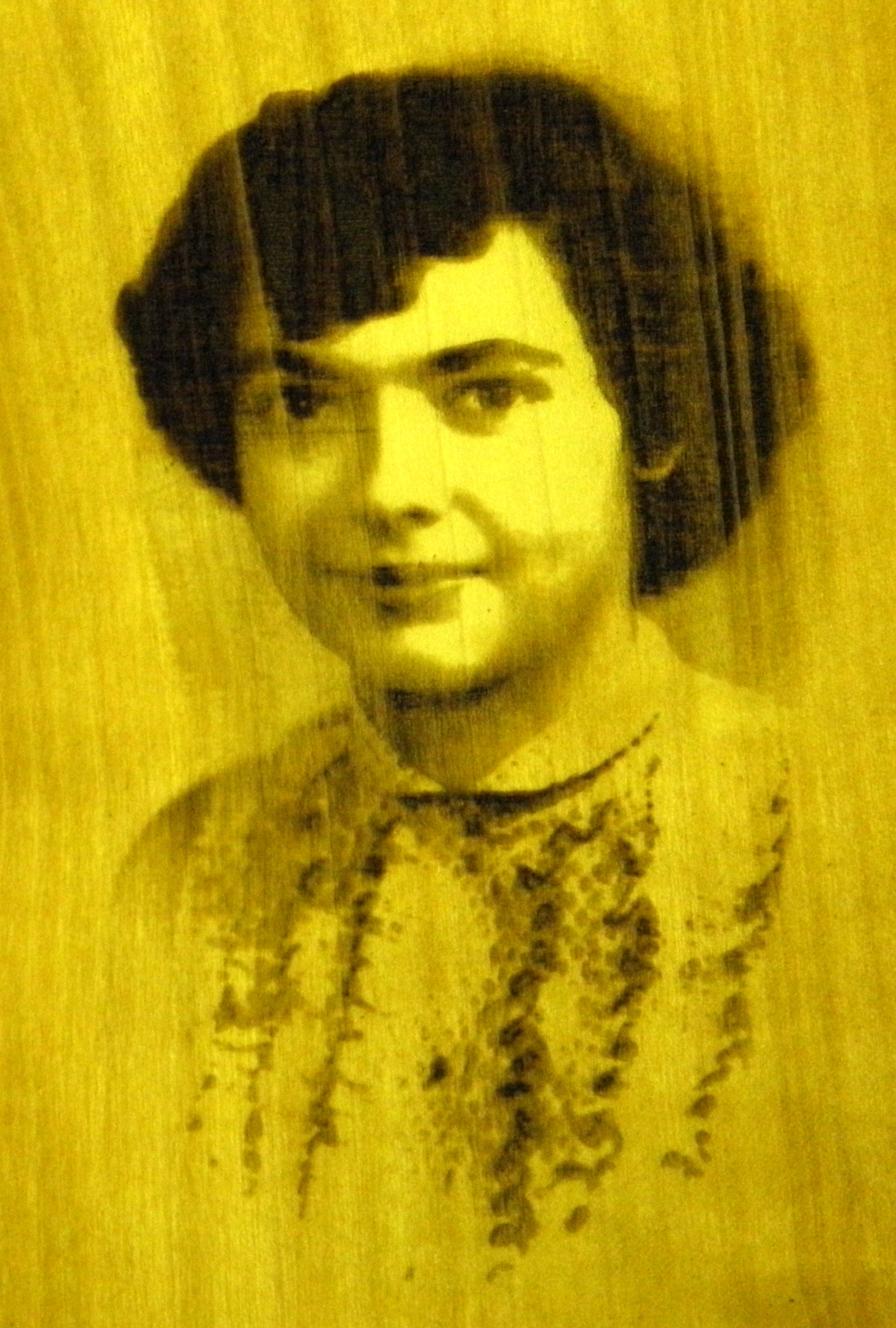

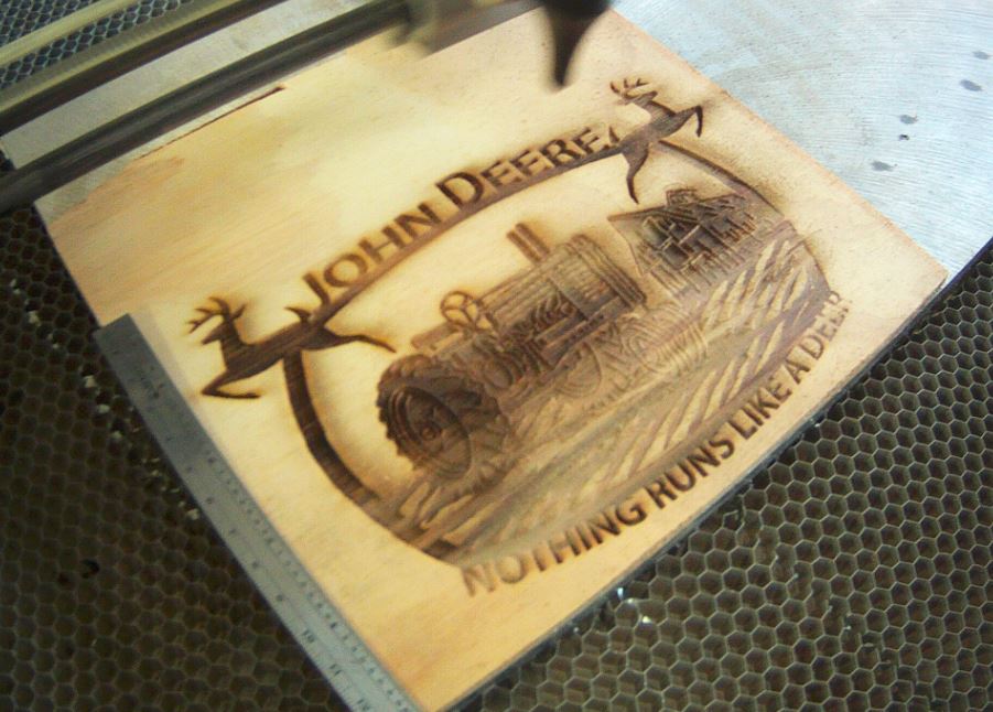

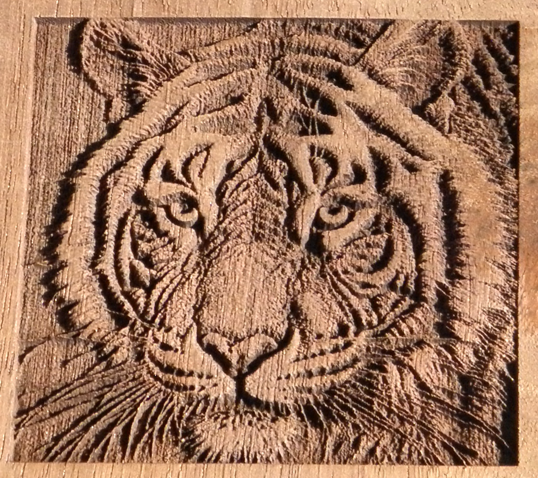

PS: As a start, here's my relief image of a Gearotic Badge..

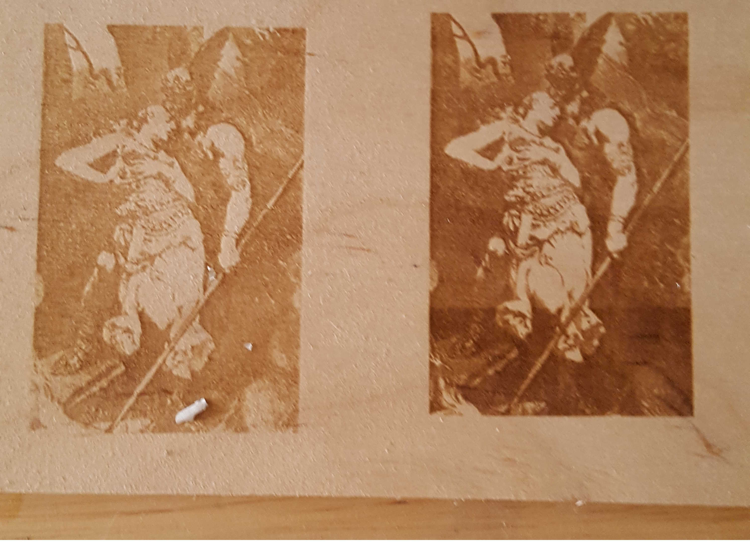

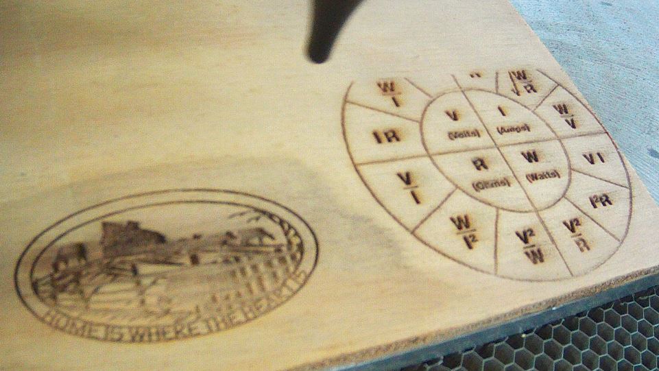

The picture I started with is on the other PC so I can't load it but.
It came from the google K40 forum that some one else had ran.
I did a screen shot and used it.
Was running at 6000mm/m and varying power outputs.
The darkest part in the bottom of the right photo was 40% and the upper half was 25% i think.
50mm/75mm picture size.
Glenn
Edit Add original photo.

It actually looks pretty good the phone camera blurs it out some.
You can see better detail. I can say with certainty the output for Grey scale is way better with Auggie than the DSP that I have.
Machine is the same for both controllers.

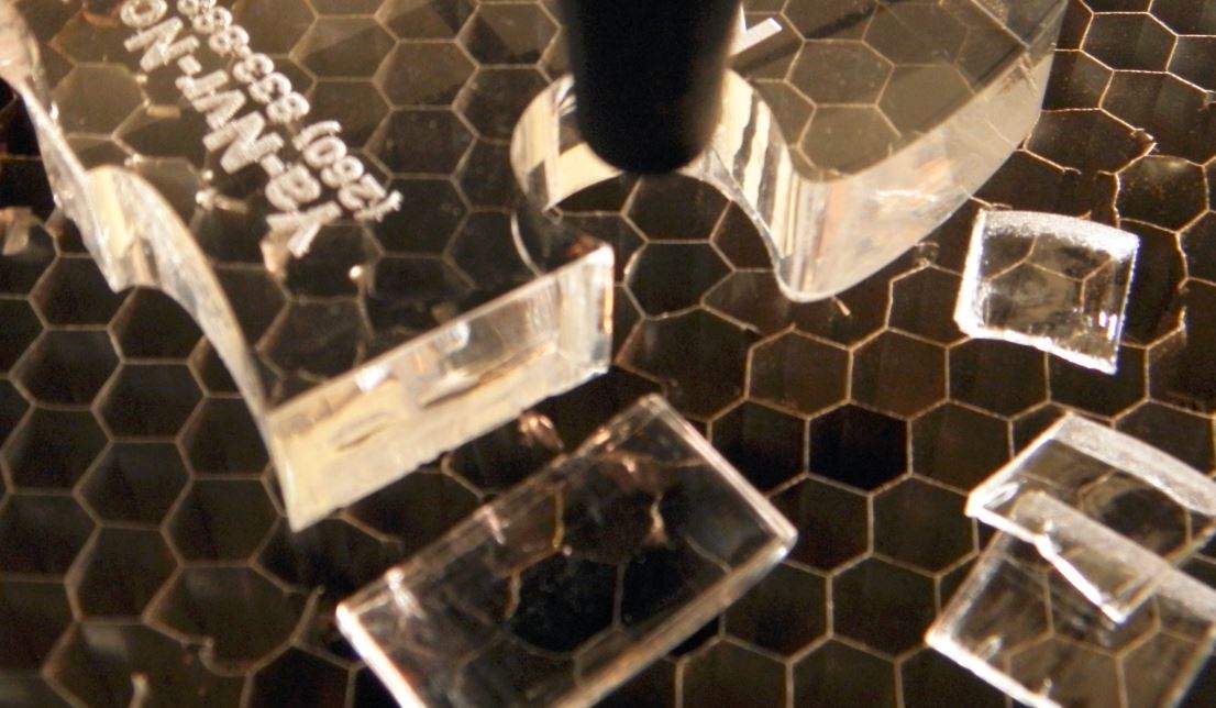

I did a simple 10 mm square.
M3
G0X0Y0
G1 X10.
Y10.
X0.
Y0.
M5
M30
Power at 90% and after 3 passes on the 5mm acrylic I didn't get through.
With the DSP i am able to get through in 2 passes pretty easily, depending on how well I have things set up.
Yep a taper issue but wasn't horrible.
With the DSP i was running 10mm/s I think I was doing 600mm/m was on last Friday so not 100% sure I am correct on that.
i am pretty sure I had the correct set up when i gave it a go.
I do know you don't want to go to slow the PWM is just to low for the speed output.
Any hints as to what i am doing wrong?
Glenn

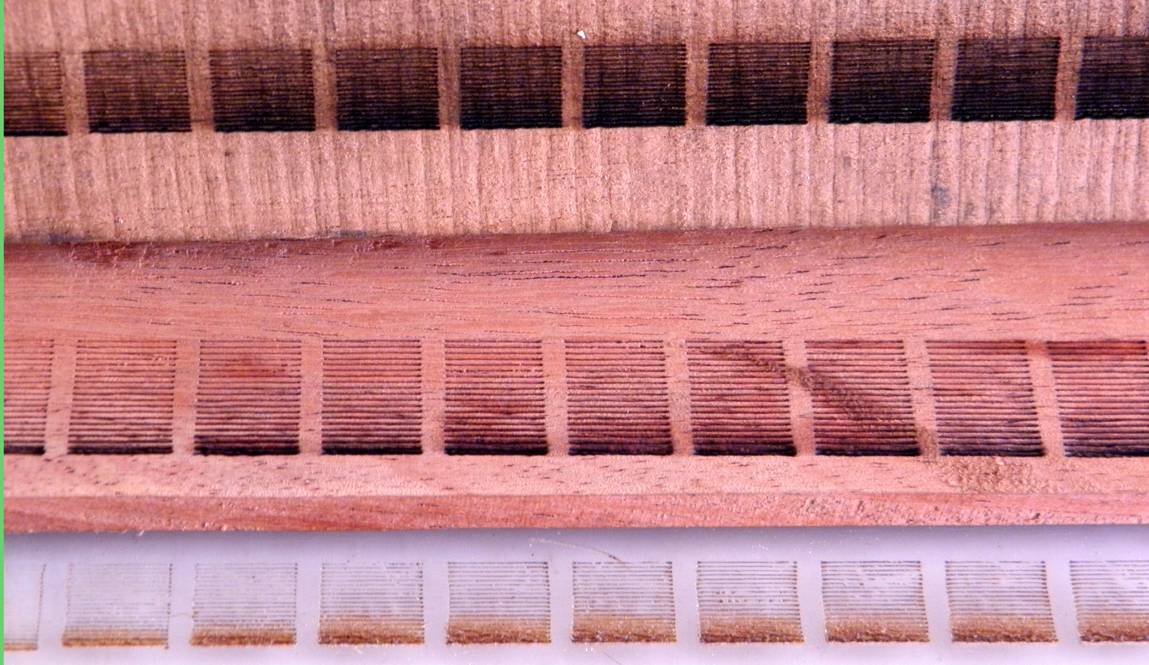

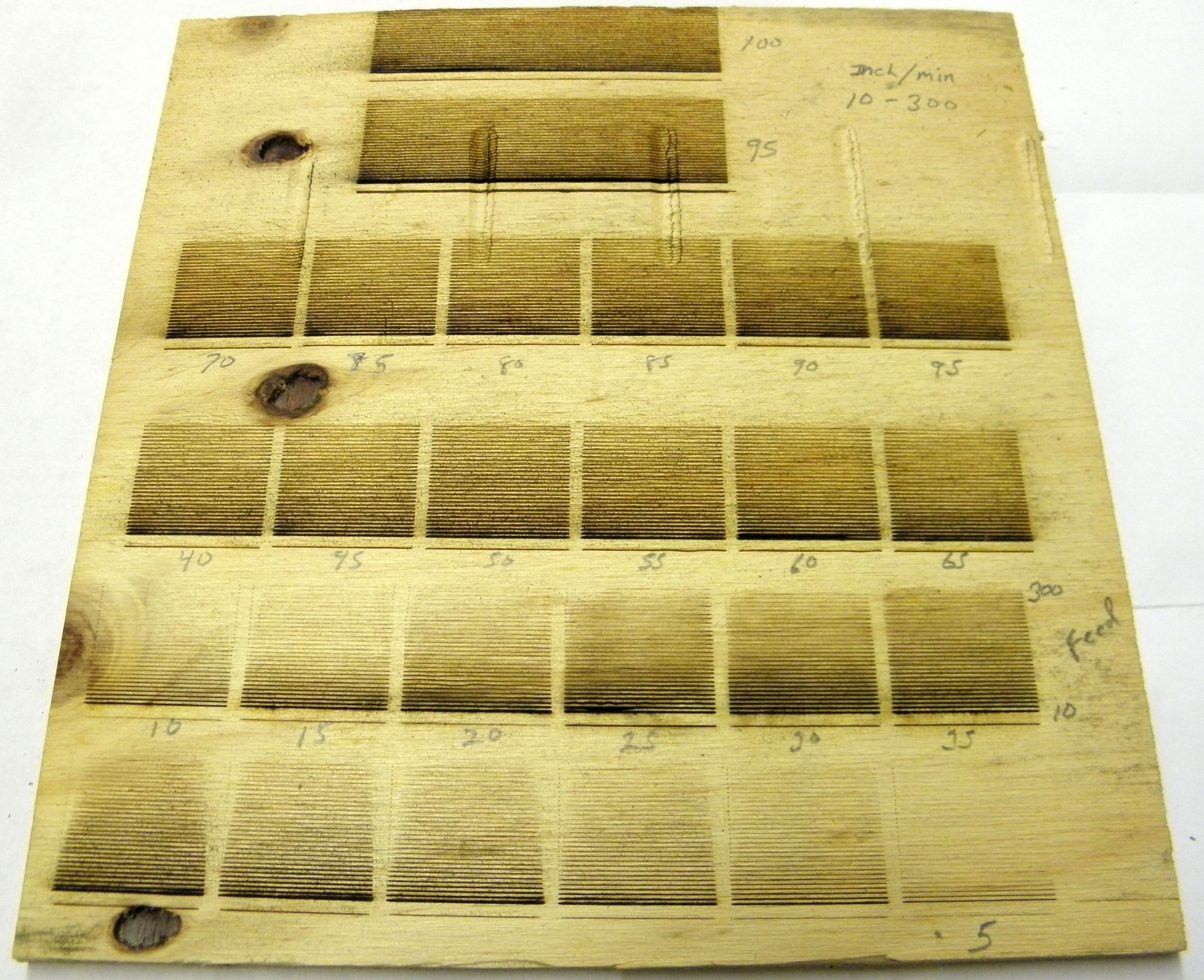

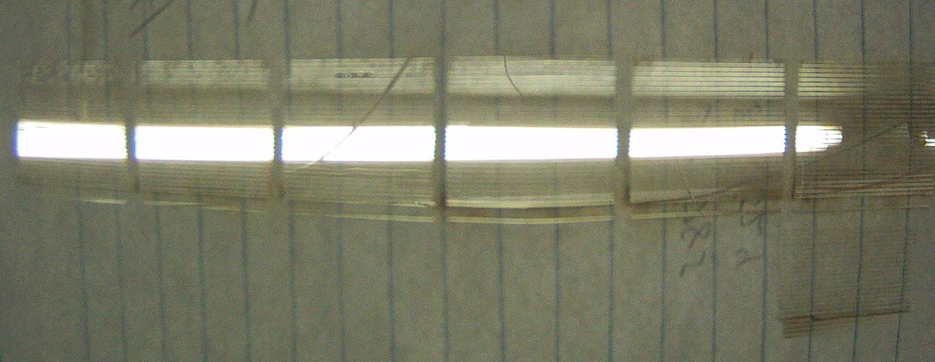

Here is a photo of my recent test of power and feeds on a Luan plywood board.
I started off at 5% power output with each line being 10" to 300" per minute @10" feed change per line
1" long the top two are 3" long.
Minimum on my K40 was set to 52 and max 100, I still need to build a boost circuit to get to the 5+ volts.
So only really getting about 80% out of the tube for power at this time.
This was a good way for me to test the physical results, the K40 ma meter and the Oscilloscope (showing PWM output).
Once I found my minimum (52) in my case that takes out the coning shape you see in the bottom row (notice the length of lines truncated as the feed increased)
I incrementally increase power for each test block sequence.
Then use a single edge razor blade to gauge depths.
My intentions are to write a routine to do this for each material I might want to use.

Here is a photo of me showing the results through a piece if note paper I tested on. (looking at a florescent lamp)

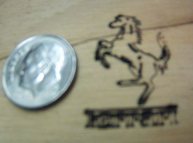

Couple of raster burn tests
and then a poor photo of a vector burn

My Initial "Walnut, Teak and Lexan" test with the following script in the MultiLine-MDI fold
from left to right; 10% to 100% power
bottom to top; feed 10 to 200 inches per min.
and an On/Off Mcode script calls for my air assist.
Code: Select all
m3 (start pulse engine)
g20 (set for imperial)
M103 (air blow on)
x=0.4;y=0;z=0;a=0;f=0;p=0;
for( j = 0; j < 10; j+=1 )
p+=10;
GlobalSet("LaserMaxPower",p);
block("MotionStill");
for( k = 0; k < 20; k+=1 )
f+=10;
GlobalSet("Feedrate",f);
Engine.FeedTo(x,y,z,a);
y+=0.03;
x2=(x-0.4);
print("feed= "+f);
Engine.RapidTo(x2,y,z,a);
x+=.5;f=0;y=0;
print("power= "+p + "\t\t x= "+x+"\t\t x2= "+x2);
Engine.RapidTo(x-.4,y,z,a);
m105 (air blow off)
g0x0y0
m30
