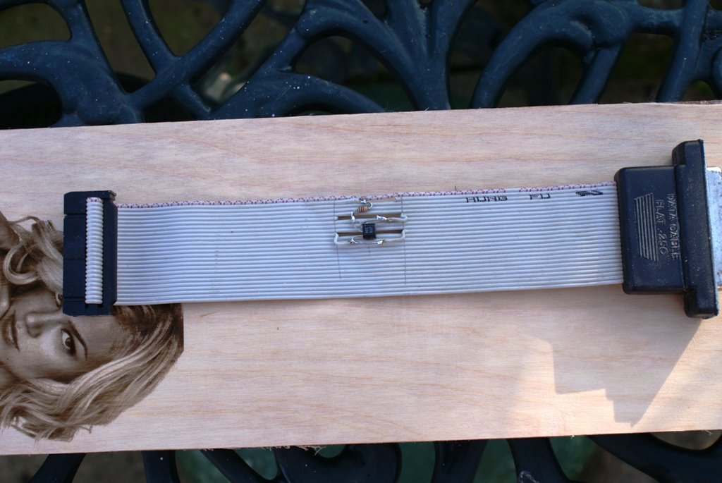

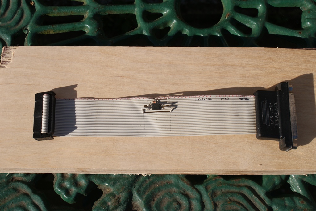

Now I appreciate that this is bit unorthodox but I have cut into a ribbon cable connector and using an opto-isolator I have inverted the PWM signal and transferred it from pin 14 to pin 16.
To be on the safe side, I am limiting the current drawn from the 57CNC pin 14 to around 5mA (which is sufficient to drive the LED in the PC123 opto-isolator) and the Vcc for the opto-transistor is provided by the pull-up resistor in my laser psu input.
A simple, quick and in-cable solution which requires no additional power source.

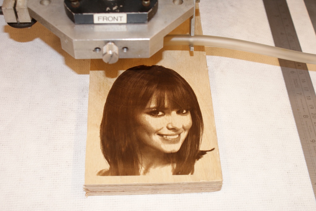

It?s alive ! :D
This is my first test run with Auggie and the laser powered up.
A couple of observations ? not problems.
1) The splash screen is not totally erased when the laser screen opens.
2) Auggie crashes when loading an image file using the AUGS button.
This only happens with the workshop WinXP computer, neither issues happen on a Win10 computer. As said it is not a problem to me as image compilations would not be made on the workshop computer and the remnants of the splash screen can be removed by changing to the default screen and back again, if I was really fussy.

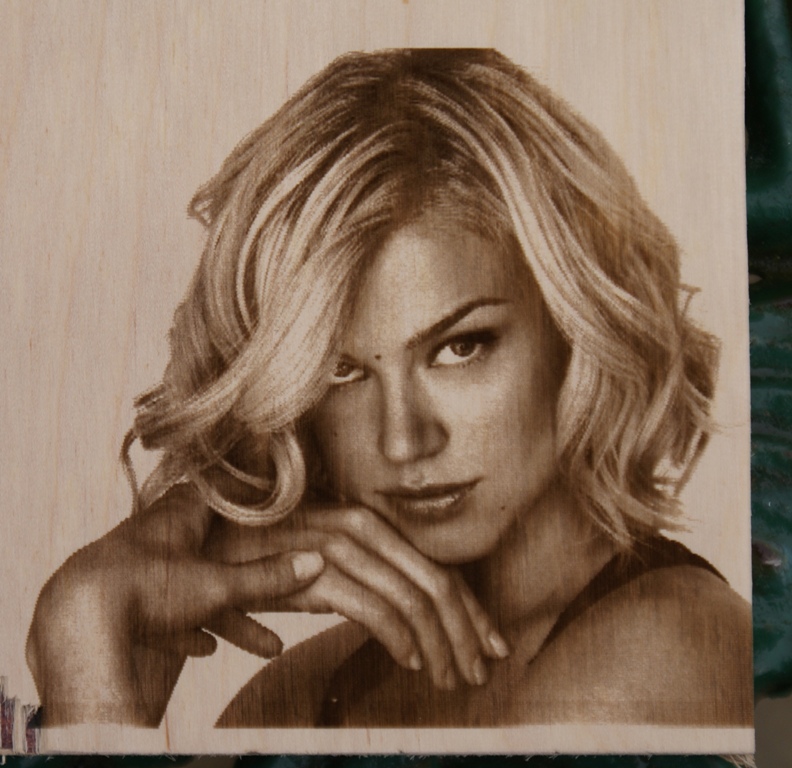

Thanks for the kind words Art but I am really not that smart ? I watched your video?s and read many of the Members posts here before I even attempted to get Auggie working ;)
It is now evident to me that there are just sooo many different settings and adjustments that can be made within Auggie that it could take some while to achieve the optimum results for any particular process or material.

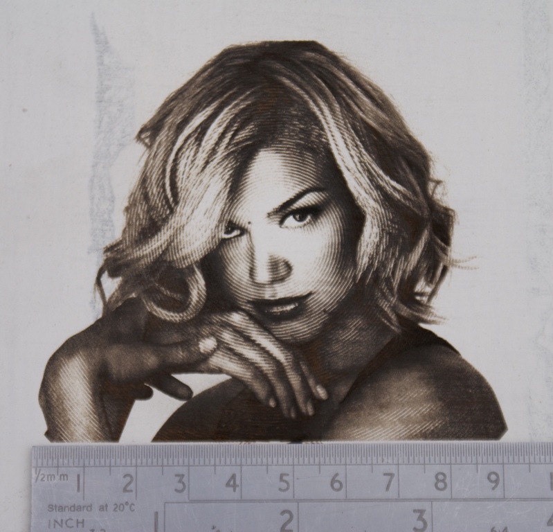

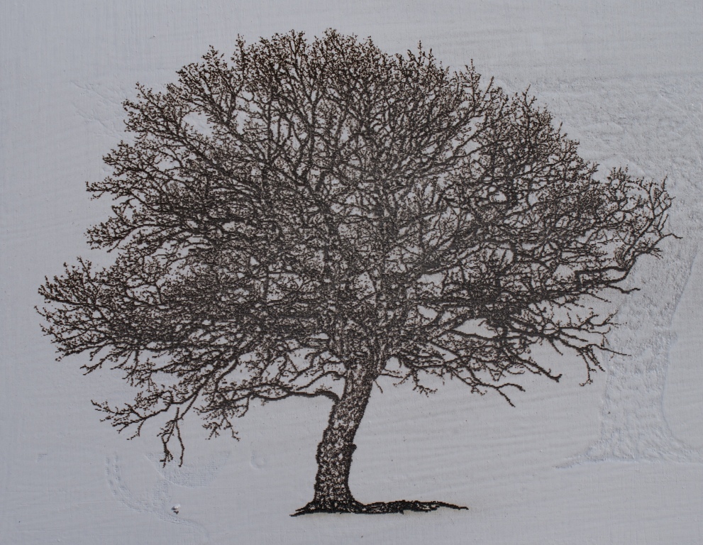

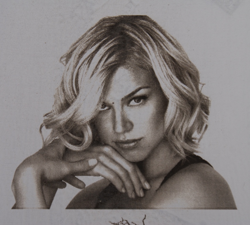

Here are a couple of attempts, using different settings, with the same 8 bit image.
I like all three. :) , the circular one is kinda nice.
In Auggie your free to make any GCode shapes, so sine waves, hilbert curves and such in Gcode
would all create interesting back pattern shapes in the burned photo. I suspect its easy to come up
with texturing patterns as well.
As to settings, there are a lot. Then there's macros you can write to do special things you
may want. Your Gcode can call macro's or even have C script in it, so may special processes
can be automated. Auggie is nothing if not versatile. With versatility though, comes
complexity so it can be a bit much to figure out all the ins and outs. ( To be honest I'm still
figuring them out myself.. I only burn with Auggie in the winters).
How do you find the "only burn with g1 motion" feature? Its my favorite thing with laser.
Any suggestions to make it better? Does your power vary properly during acceleration to
smooth out burn marks typically found in non-corrected motion? Ill be back at Auggie when
Vexx is released so feel free to plug any suggestions you may have.

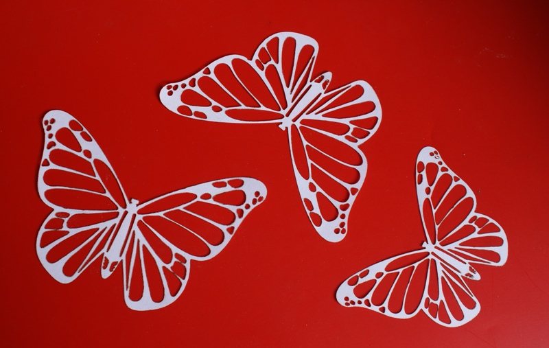

I have just tried some vector cutting as a test of the varying PWM with velocity. My test Gcode is approx. 50/50 arc?s and straight lines so should be a good test.
The results were not quite what I was expecting?
At a maximum set feed-rate of 6000 I was only achieving a max. of 30% PWM but at a maximum set feed-rate of 500 then I was achieving a max. of 100% PWM.
At first sight it appears that the PWM duty cycle is reducing as velocity increases ? the exact opposite of what I was expecting.
I am wondering if I have screwed something up in my software settings somewhere ?
Hi Tweak:
Well, its hard to say. But, let me explain how that works.
Lets say you have set a max speed of 6000. Whenever the head is moving
in a G1, it computes the speed for that ms by the number of steps it will
take during that ms ( on each axis so vectored to a directional speed. ).
So if, just like the days of M3's CV modes, you command a speed which
the head doesn't truly reach, the speed will never hit 100%. If I run RoadRunner
for example, and the max speed it hits is 340mm/sec due to speed/accel/Jerk
constraints in the run, and I have commanded 1000 as a feedrate, the max PWM
during that run at its fastest point will be 34%. Commanding a higher feedrate will
further lower the laser power reached.
So in a vectored mode, the feedrate commanded is a master setting of top
power as well as speed by virtue of end resultant speed. What I do is a test run in air,

I noted last time I used this ( to cut out a vine in paper ) that it needs a bit of work, it works but
I found it hard to tune the power/feedrate curve. I plan this winter to add a better way of calibrating
the power/speed curves so one can more easily find the sweet spot for a cut. My thought is that it'd
be better to allow a user to set a speed curve designed for that cut or machine.
Because this can be hard to tune, there is a button on the laser panel to turn off this speed
correction. Its labeled "DistCor" and will turn off the acceleration checking. This will give you selected
power whenever it moves. This , of course, leads to burning in corners and slow area's just like my co2 laser
does when run from its firmware instead of Auggie.
Most co2 laser engravers take care of this with speed, they try to do a constant speed as much as they can
and allow for burning too much on corners and slow areas. As they have low mass heads they can do a pretty
good job of constant speed most of the time. My laser is high mass, I have to use anti-jerk control
for smoothness and this is why distcor exists. I have to use acceleration and jerk limiting, and this makes
full power lasing on vectors difficult. When tuned in by selecting proper feed and such the vectors seem to
work fine.
So turn off DistCor and you should get full selected power during any ms of motion, kinda like Mach3's on/off
P commands without having to enter them. You can also slide the laser power slider even during a run for
fine correction.
Lastly, the accel/jerk limits play a part as they control just how slow youll have to go in corners. If you adjust
Jerk Limits upwards, you make it faster on the curves, this is a hard one to tune, some may have jerk set to 5000,
I set mine quite frequently to 500,000 depending on what type of work Im doing on it. It takes some experimenting
during a vector run to find your best jerk setting if your using DistCor to smooth out power.
So this winter Ill be looking into better ways to smooth this out, perhaps with user settable speed/power curves
for better control of end power in various situations. YaNvrNo is my main laser tester, and we both noticed that
vectors take some tuning to do and speed curves we discussed as a way of getting a better result.
So, lots to play with there, turn off DistCor though and a vector cut is much easier and works more like the
normal engraver does and should mimic M3's P modes for on/off.
Yell if you dont have a DistCor button, Im pretty sure I put it in the release, its on my panel..
Let me know how you make out,

Many thanks for the extremely detailed explanation. I had spotted the Distance Correction button but had no idea of it?s purpose or function. Once you mention it then it is obvious that I could not get anywhere near to the 6000 set feed-rate thus the reduced PWM ? it all makes sense now ? thanks again.
I am just loving the ?AUGS? button and Auggie?s variable PWM laser power control together with the ?S curve? Accel / Decel and motion from the 57CNC. My machine is loving it as well ? much quieter and smoother in operation which is certainly kind to all the mechanicals. My 8 bit photo reproduction is going to be heading to new levels ;D
