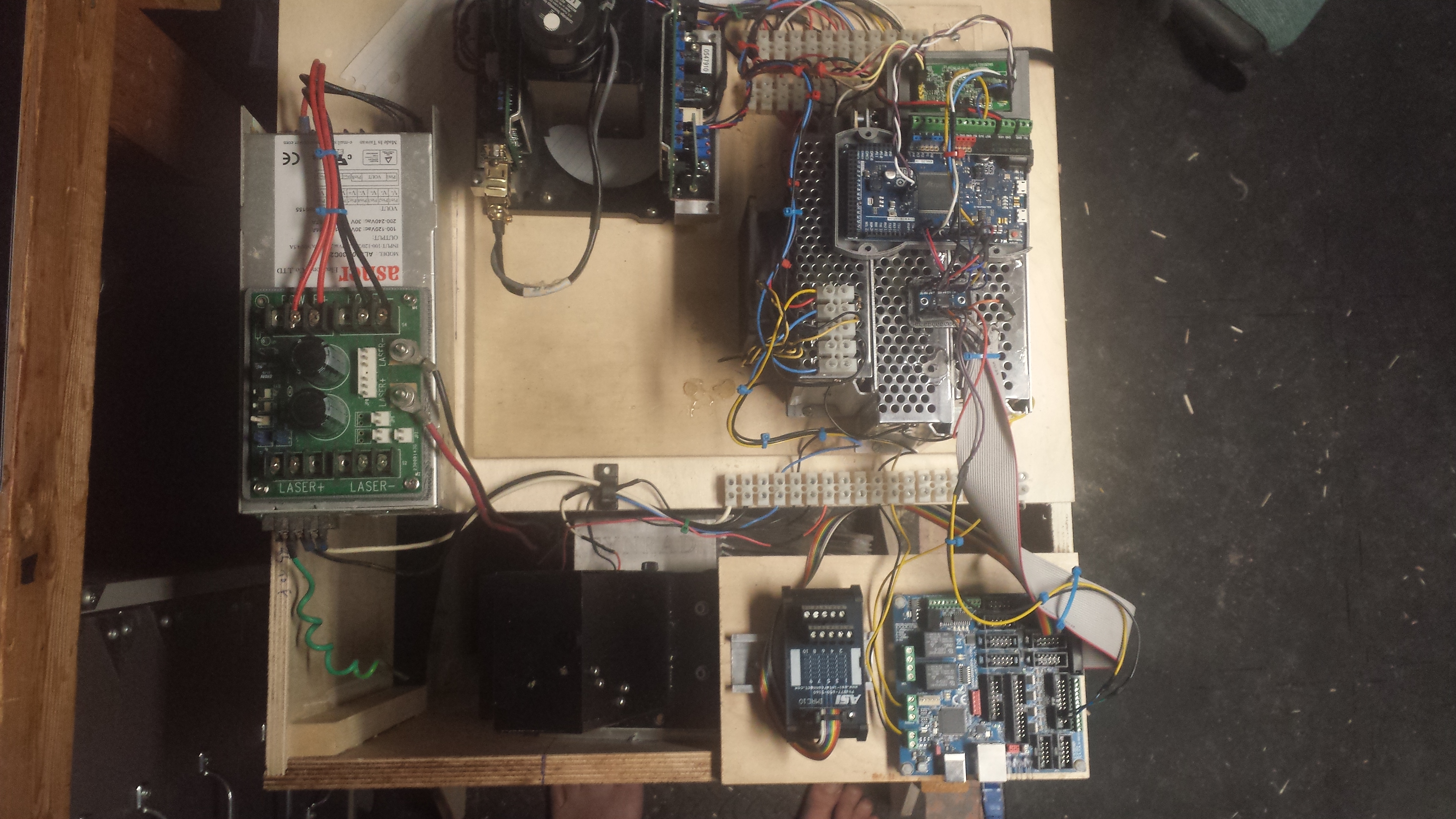

Re: Its Alive!!
Just finally got Auggie driving a galvo cube. Seems to run up to 100K steps per second. Long way to go till Im done but its nice to see jogging on a galvo set, just a
little red dot moving about as you jog. :)
I like the new 57cnc, seems solid, though the pin changes threw me a bit.

My galvos, like many you find on ebay from marking heads ( Cambridge scanners )
are pretty quick, I think they were rated at 50K points per second. Im sending more than that , about 100K per second. Mine take +-10volts to work, so Im using a board
called an armfly dac. ( about $35 ) It takes 3.3 volts from my arduino DUE for power, and 40mhz spi to set the dual dac. It puts out dual +- 10 volts, so 1 board will feed 2 galvos. Clever little board even makes the +-10 supplies on its own.
The CNC57 then, just feeds step/dir signals to the DUE, which then sets the
DAC from interrupts on the step pins. The armfly is 16 bit dac's, so I get 65535 steps
for total field width. That seems too high a res, so Im counting by 2's, making it
really 32767 for width of field. Ive also programmed the arduino to clip at 0 and full count, and put out a home switch signal at any attempt to go below a count of
zero. This makes the CNC57 run fine on its homing routines and the two mirrors
now behave just like any cnc table's axis X/Y drives.
If your interested in POV, this settup would work for mirror motion, but youd need software to drive them, Auggie couldnt. Auggie relies on the step/dir paradigm, it cant send analogue data values serially, and if it could it would then need a blanking setup as well.
When done as step/dir, Auggie can use the laser as a normal one, so photo
engraving should be possible with the standard 1ms update rate. The 1ms
laser power loop is important to speed, if you cross the field in .3 seconds
during a photo engraving, thats only 330ms, so 330 power levels from the laser.
So most of the time one would want to take at least 1 second per raster, for
1000 power levels of resolution per scan line. I figure most of my time saving
from galvo will be in the acceleration and deceleration removal as the mirrors
dont seem to require any, constant speed is possible on even small curves and corners.
PPS Speed: The meaning of PPS is really loose I find. Galvo's it turns out have small angle design or large angle design. If large angle at 30KPS, it means you can virtually send it any ADC count, no matter how different from the previous one and it will move fast enough to do 30K of them per second.
Mine are very good quality , but I cant do that, I tried it and the cube got noisy as hell as it pinged around so fast you couldnt see it move. But even if I wanted to use
it that way, it would be a fair amount of work to write software to make it go as youd
have to send an analogue word for each dac for each step.
This is why I made the DUE run as a step/dir driver does, simply counting step pulses and updateing the dac when it sees a difference from last dac setting. The DUE
is 84Mhz and seems to be able to do the interrupts at about 100k or so without locking up due to ISR latency.
So, with 32768 positions from left to right, the pokeys needs to put out
only 32Khz to get a 1 second field sweep, so at 100khz , its about .3 seconds in
theory for the field width and height. If Im lucky with my lens, I may get
300mm width, so res would be 300/32767 so about .009 mm per step. Smaller
lens fields get ridiculous in resolution per step.
Speed is all about final field size if using it for laser burning. This is probably fast
enough for a sweet engraver, but for POV I dont think so. The DUE and armfly would work OK I think, but youd have to send it a data frame then tell it to repeat the frame at full speed, then POV wouldnt be an issue.
Anyway, just a few considerations. Im now waiting for new gold mirrors, my cube was yag and has the wrong mirror type. Then it will be onto the F-theta issue. Theres still a lot of bumps on my road yet I think. :)

Heres a photo of the galvo hookup, you can see an Arduino DUE, and just above it an
armfly DAC board. The small chip under the DUE is just a level shifter to match the step/dir voltage levels from the CNC57 to the DUE.

thank for the info art , PPS now I understand a little bit more
i'm thinking the beam spread of a diode laser would make a galvo
engraver impractical but it would be nice and quiet .
yes that makes perfect sense . I have one recovered from a old laser printer , I will spin it up and see how well it reflects a blue laser.one polygon mirror for speed
when I say 300 pixels I really meant mono bmp style , laser on or off .
if I preprocess the image and store it in progmem I think it's doable with an 8bit micro.
a constant raster from a rotating mirror cuts the processing load to a manageable level.
its headed me off in a different direction.
armfly dac , google has very little to say about them / or where to get one . do you have a link ?
