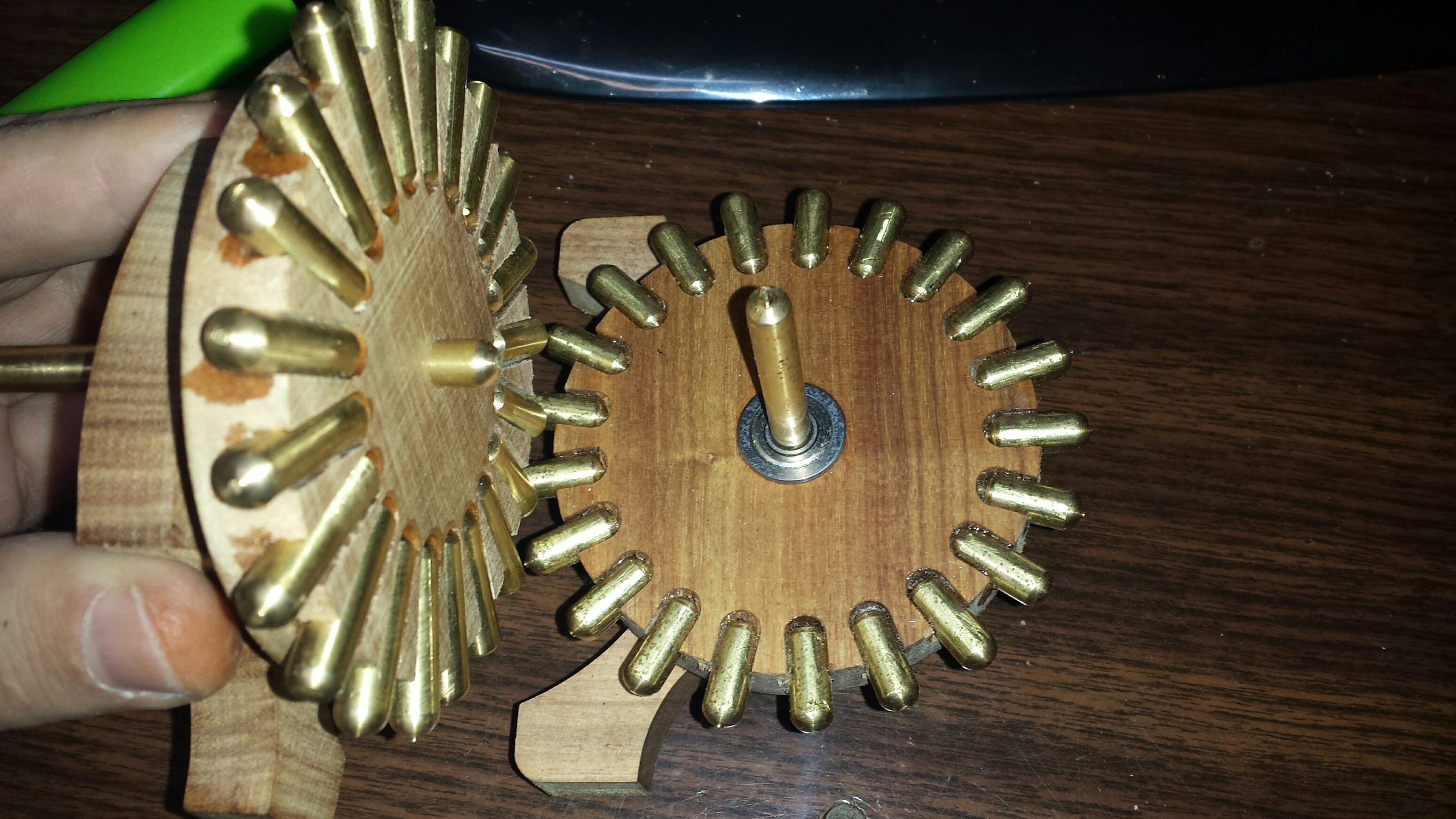

For a "bevel cage gear" were you picturing something like the attached photo? Or
were you picturing something more like a flat plate with pins rising up from it? I to
am trying to come up with a better way of getting 90 degree drive for hobby
projects and built the enclosed recently as a test. Of course any solution for bevels
is a question of how much power and torque they will handle and as yet I have no
real good solution.

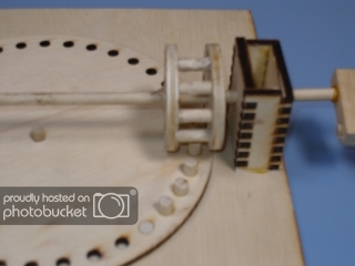

As far as the cage bevel thing goes I have attached a couple of images I found on the web. I guess they're calling them peg gears. Since this is just going to be a hand cranked toy it won't be high speed/torque so I would think this kind of gearing would work fine. I'm going to try cutting out some cage gears later today and see if my method of creating two pegged wheels works. I'm hoping that with the fix to the boxing routine I might be able to create the box with standard bevel gears and then use the cage gears in the actual assembly.
I have also attached the gth file showing what it looks like when I replace standard bevel gears with cage wheels. Thought you might like to see what I'm trying to do.
