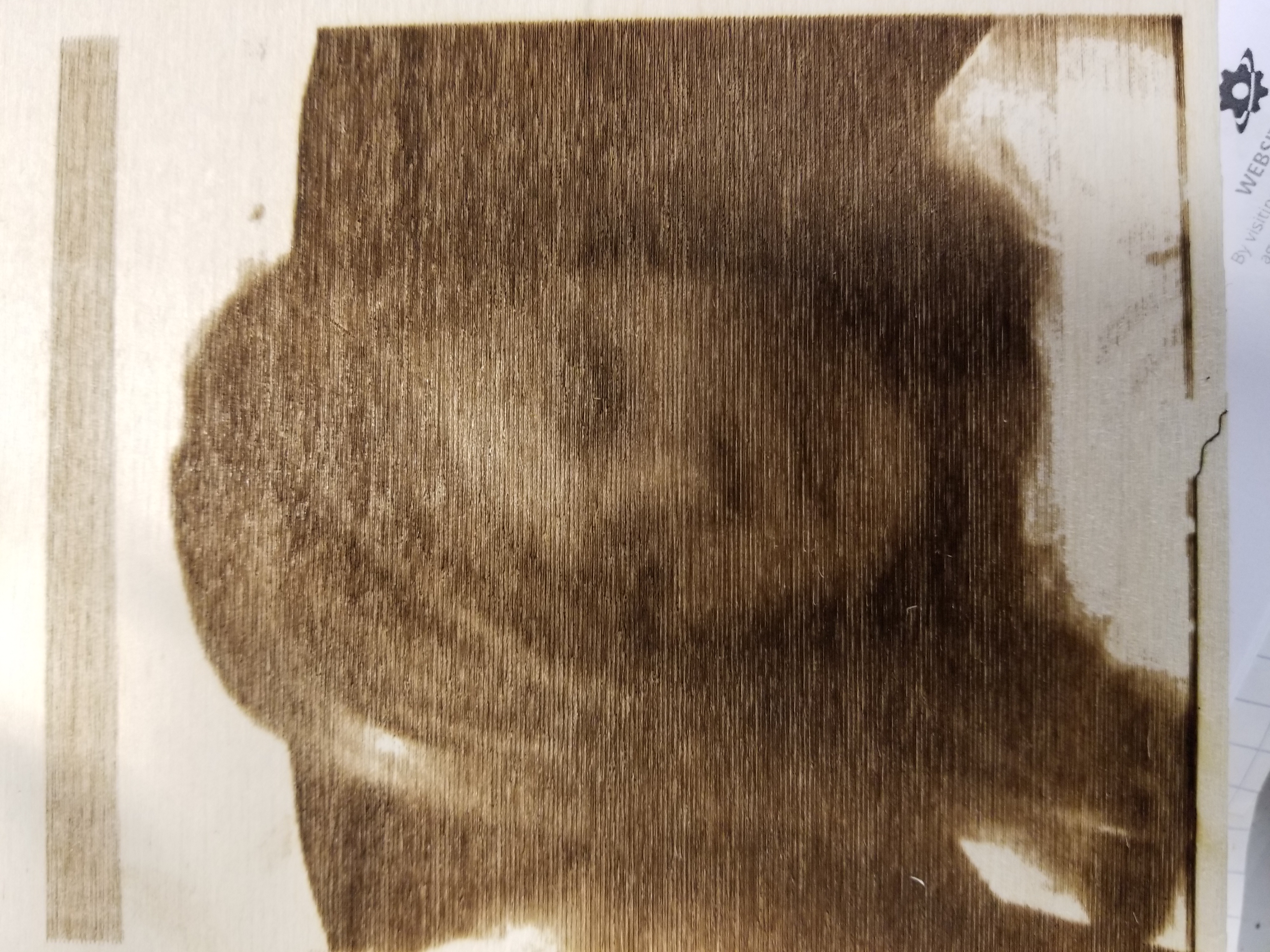

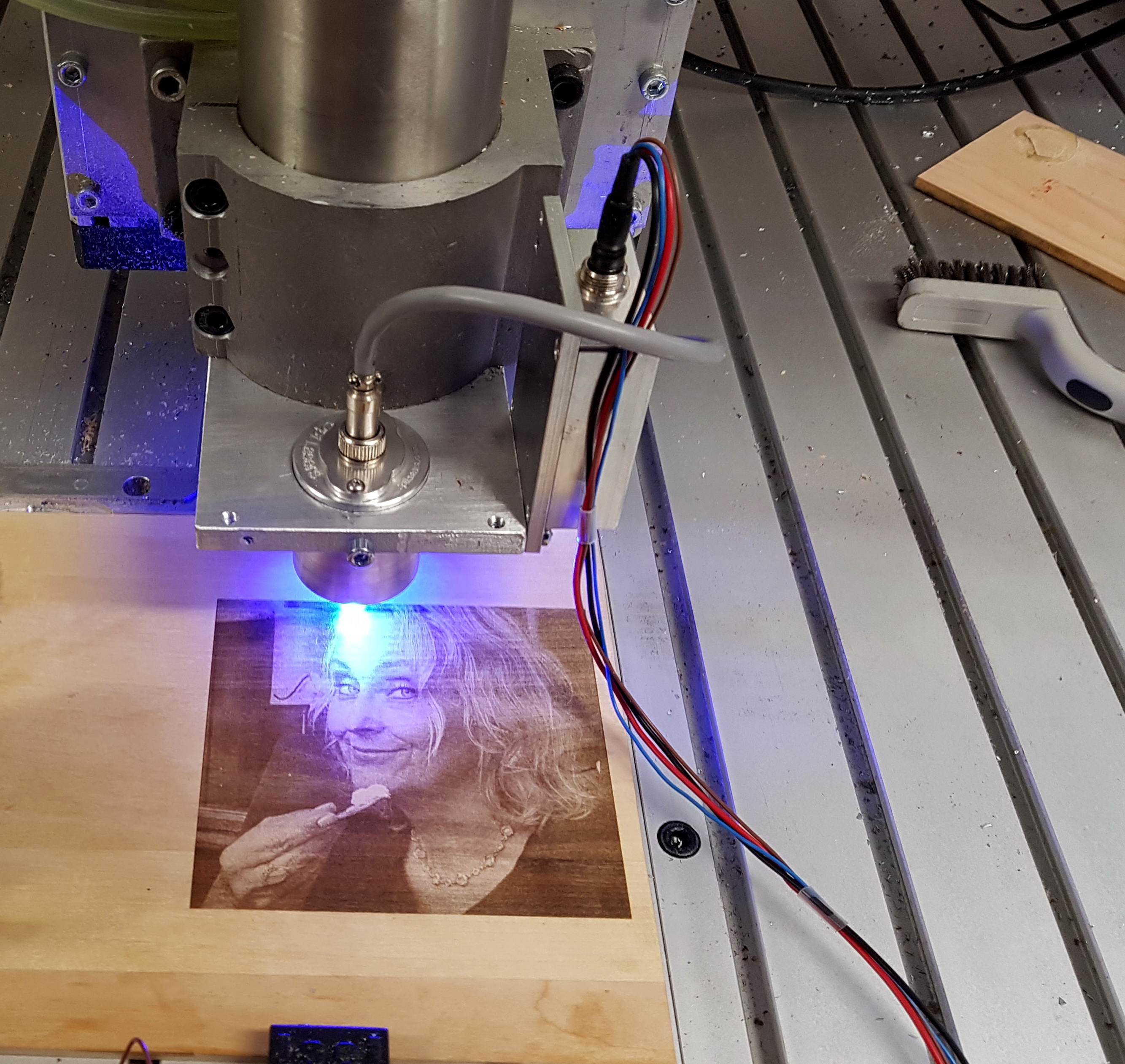

Here is my first attempt. Too dark. But none of the "over burning" that I saw using LINUXCNC and standard Gcode. I used PWM defaults in AUGS ap. My laser diode is 455nm 10W at 40ipm. It took 1hr 1min. I haven't tried vector engraving yet. Wish me luck.
Mark
Oops. I loaded the wrong video. I apologize to the owner of the attached video. I don't know how top edit and delete it. I did manage to load the correct pic of my raster engraving.
Mark

Re: PWM Config/Connection Help Needed
Mark:
Awesome, looks like your there. Of course, you'll be fiddleing with settings to find your
sweet spots, but Im glad to see such a nice test image..
