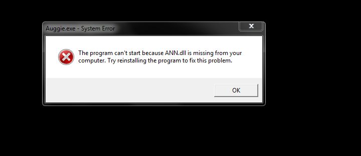

Ha ha off to a promising start ;)
Win7 Enterprise, 32bit

Re: Getting back into CNC
  You need to install Auggie only over a demo install of Gearotic. This makes sure all the files
are available.

ArtF wrote: Hi:
are available.
I has the same problem on second PC. Both running win7 . On first one work like a charm 32bit , on second one 64bit i has the same problem , reinstall Gearotic didn't solve > I solve downloading random DLL fom net > Copy ANN.dll from working 32bit PC didn't work also. This one i download >
Bobby
ANN.zip
(95 KiB) Downloaded 852 times
Thanks Bobby..
  Ill see if I can see why this is so. I use a 64 bit Win7 with no trouble with the install.
Another of those odd troubles that only affect some machines...
Thanks for the post, it may help others.
