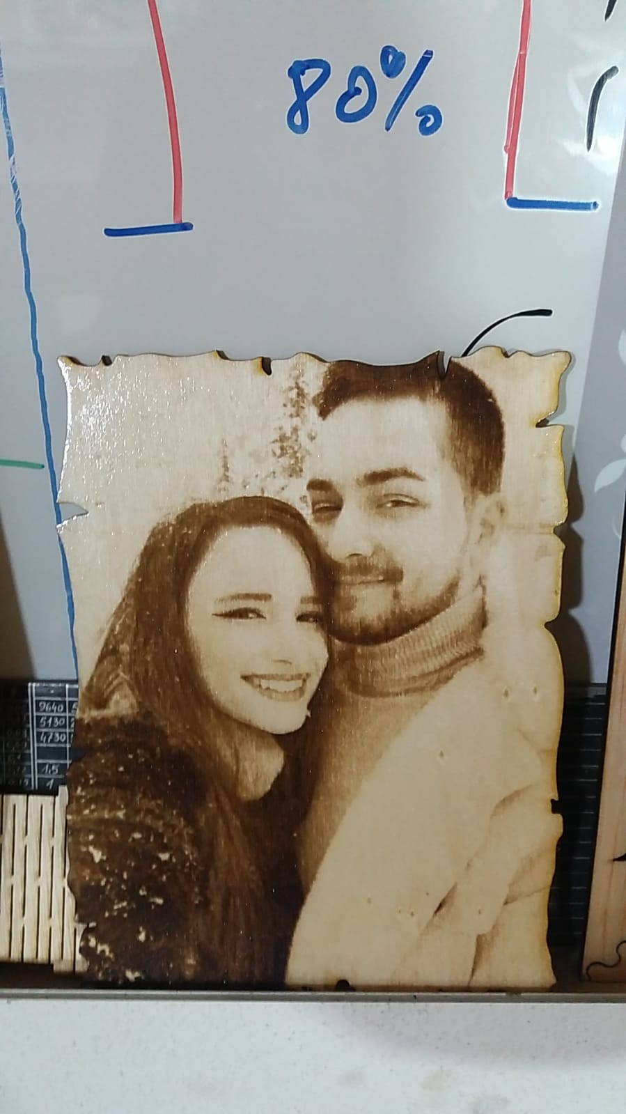

Re: Polywood , Auggie and sugar
Very nice.. Thanks for the tip..
Thanks Art.

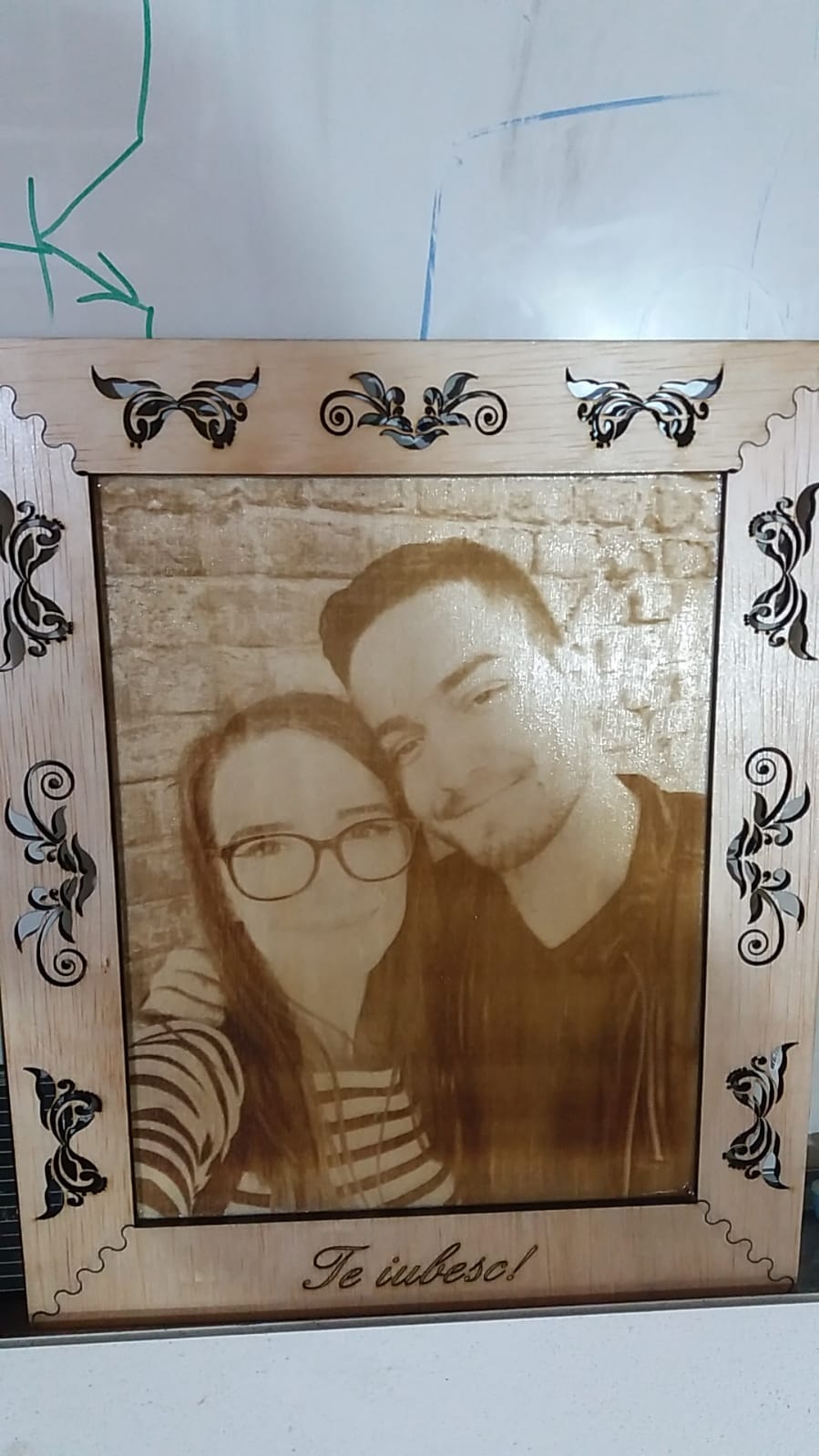

Well , i test today and the polywood was realy realy dry.
Usualy in that situation the "black"level will never come visible.
Even you increase the power or decrease speed , laser will simply goo deep cut and will be like 30% maximum
level of dark. A simple example is in picture below. The cut is very low level, so
in that situation , is impossible to get dark parts as should be .
So i apply the sugar on surface and i made a test . Dimension is 215x279mm.
I let 30min to dry and i start engraving . Take 28 min on that photo to finish.

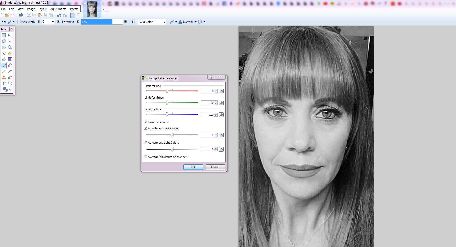

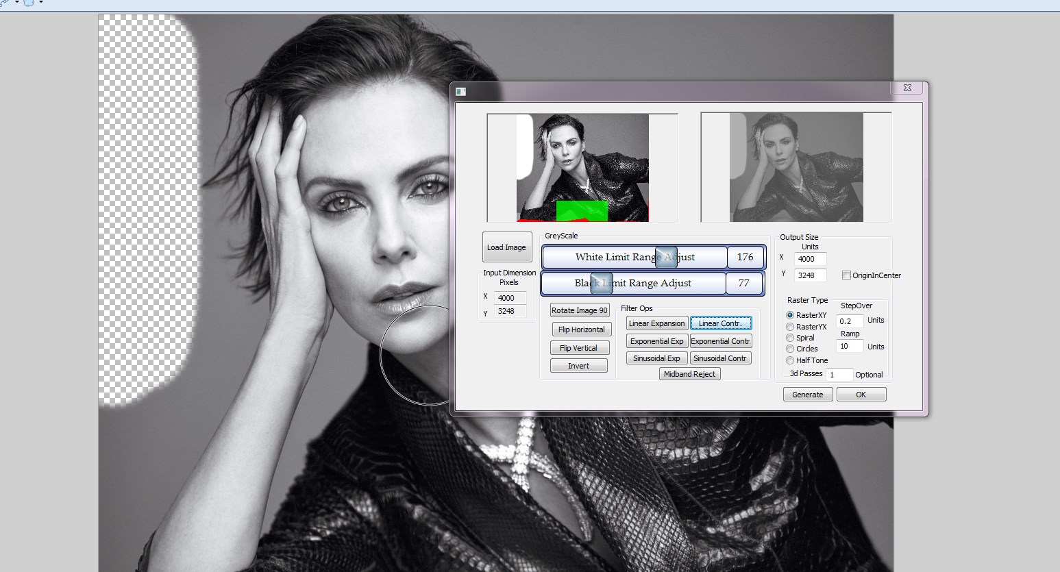

Usualy i made the photo grayscale before import in Auggie with color limit
at 100.I put the pic below. I use paint.net , is free and so many extensions.
In Auggie i use linear contrast and always limit at 100 , on screen look little creepy
but the result not.

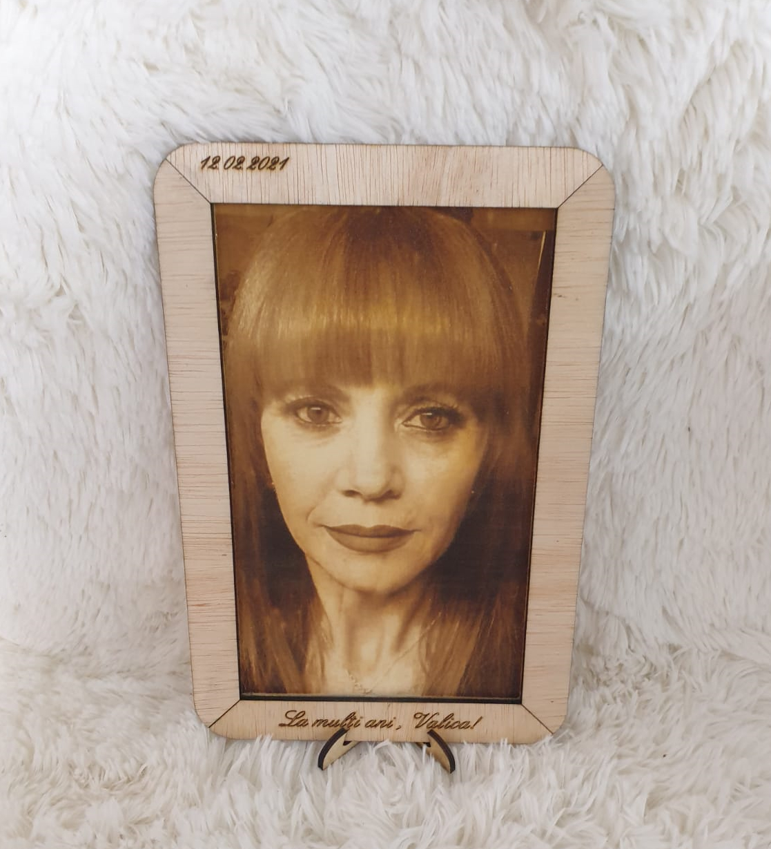

I put the pic below with result after sugar apply .
100ml boiling wather , 2 spoon of sugar let cool down and apply with a brush.
Bobby

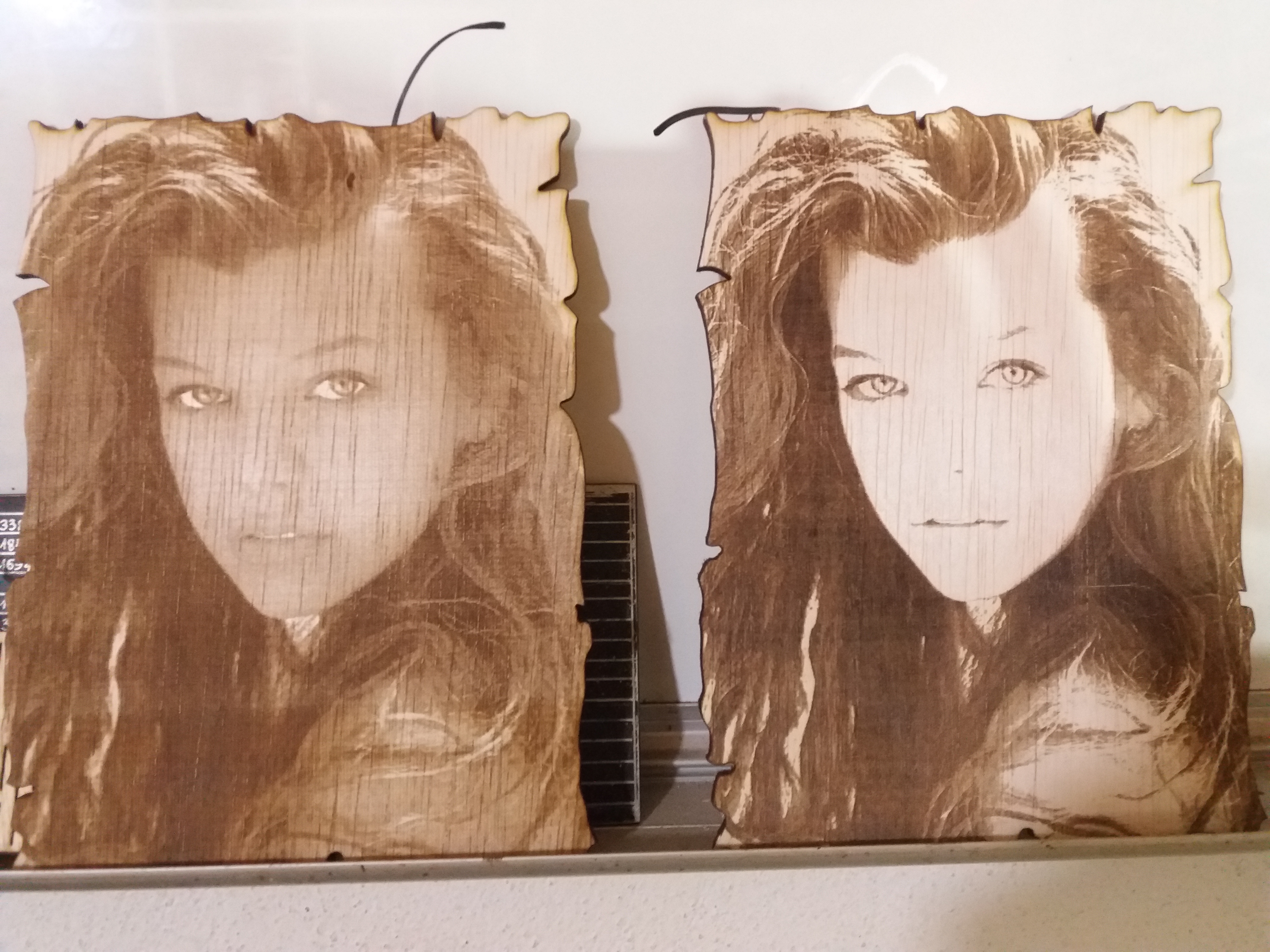

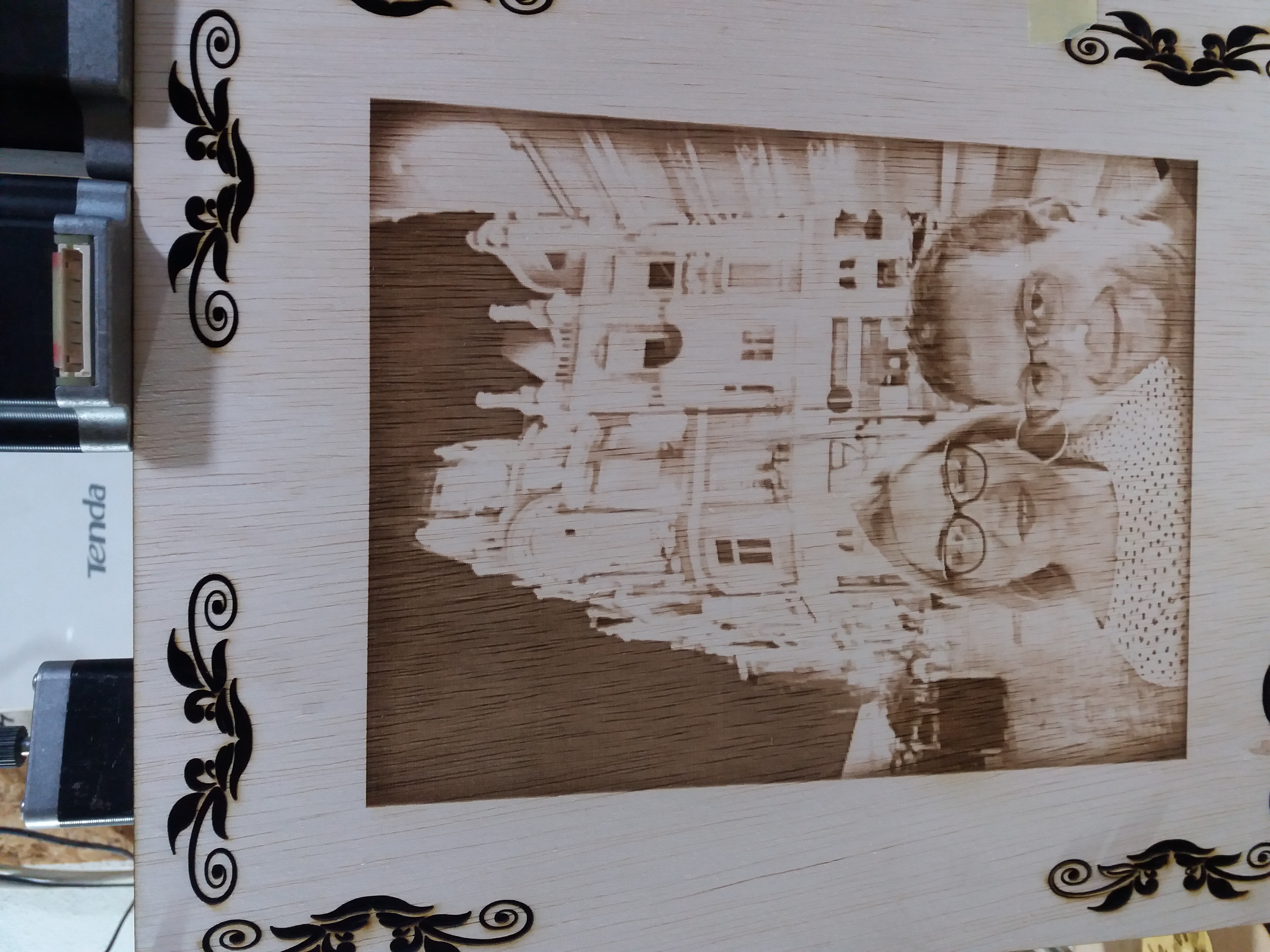

Well i always assume , doesn't matte how you system is , the PWM willArtF wrote: Thats REALLY good. I still havent got around to trying that as yet, but it sounds
like a great technique..

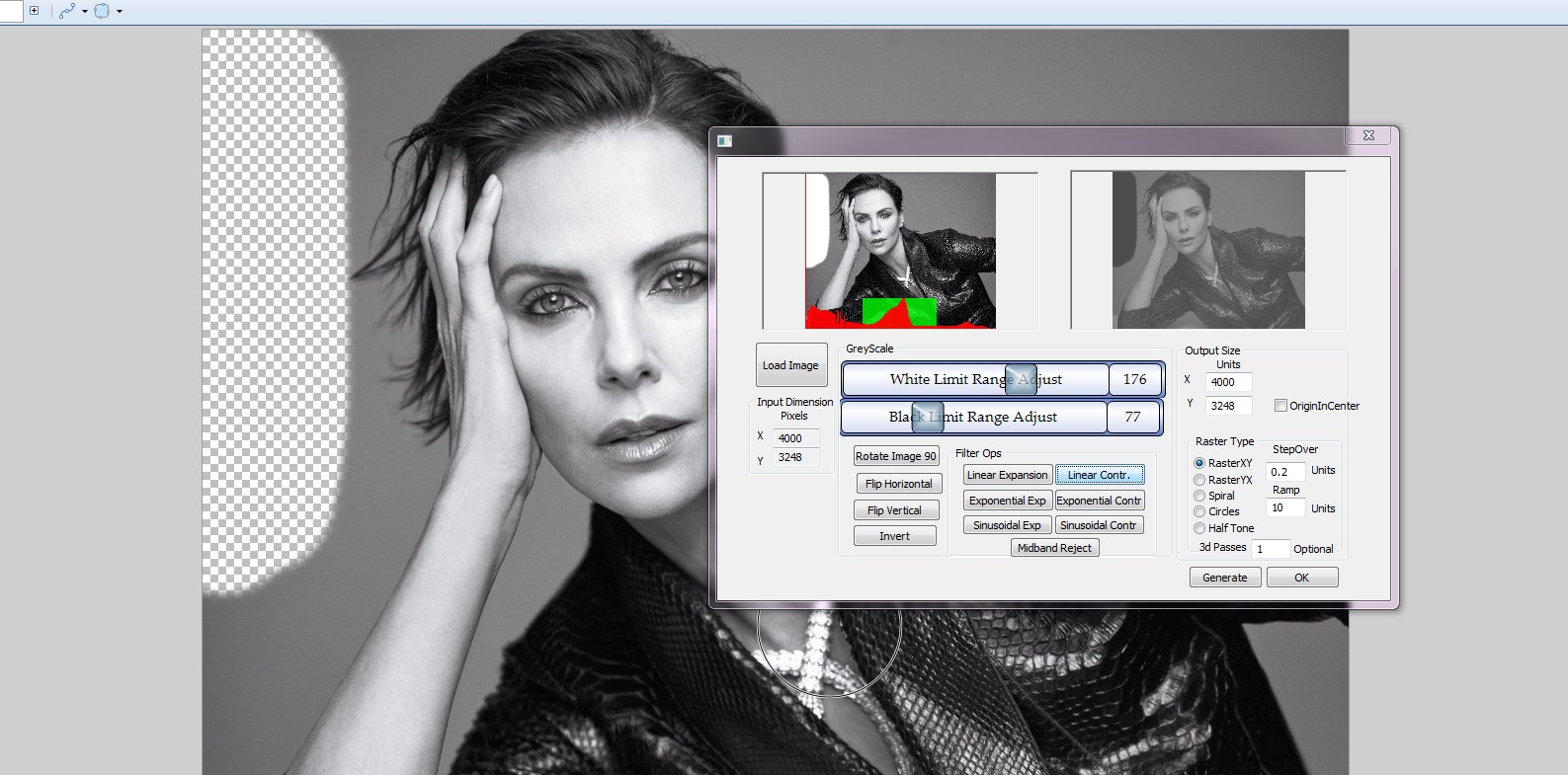

never exceed 100. That why i limit all colors to 100 and after i transform in grayscale pic.
Also in Auggie i always limit white to 178 and black to 77 , i assume like
that will be in PWM full range.
Even like that speed is essential. As example in 2 pic below .
The right one is almost perfect (power was little low) but doesn't matter because i know
was my fault and the speed was 4000. Made the pic in 23min .
The left one i was increase the power a little and speed to 8000 and half time at engrave.
But as you can see , timing was tealy short for each pixel and didn't have
time to reach full black level on wood.
Both was with sugar , but was different type of wood , from indonesia "albasia".
I try before on that wood but didn't work so well. Now with sugar the result are different of course.
Still should be beautiful if you have time in " one day ' to made the AUGS window more bigger
or possibility to be resized . :)
I put the pic below
Bobby

Also i figure out other thing . I dont know if is a bug , or like that should be.
If i edit any pic and i erase background is some place's or total
and i save it .JPG and load in AUGS is ok . The background zone is white like
" no pixel level information " .
If i save it as .BMP and load in AUGS the background will become black .
That is normal ? Why the difference between 2 formats?
I mean the AUGS dont use the same " pixel read " altgorithm ?
Thanks.
Bobby
Its possible the jpg has a transparency color defined as black, where the bitmap simply defines black as black.

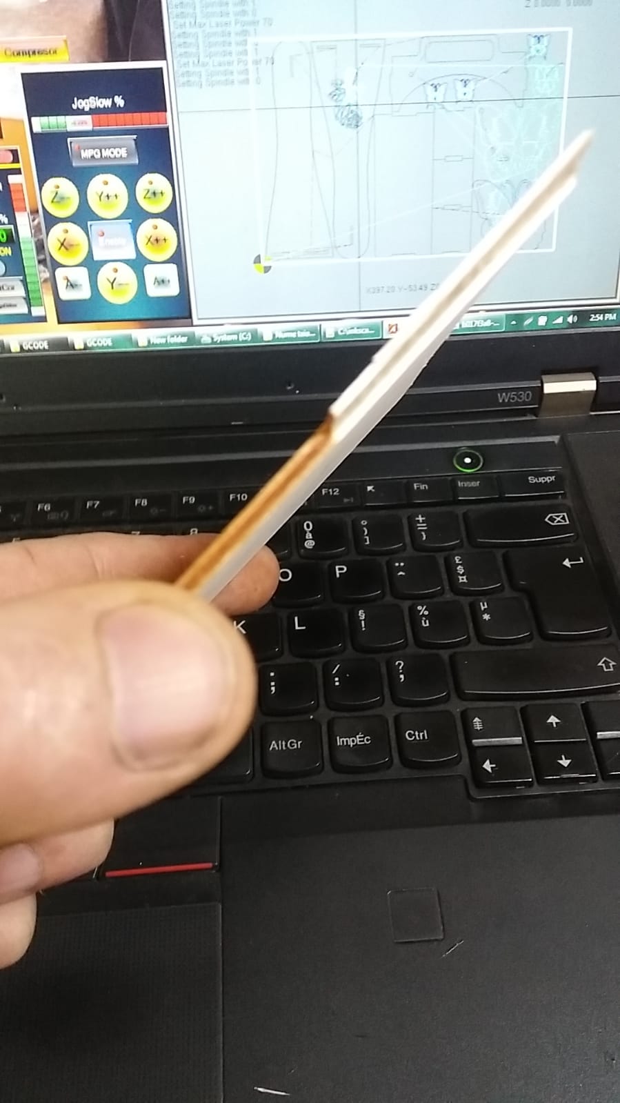

Other sugar test , on different material with maxim speed .
The low black lever dont apeear anymore , because the beam dont have time to burn deep
but the job was done in 6min .
Of course the result is not the same as at low speed , when the black turn to black.
I notice , to low speed is bad , to high is also bad , so i think for any machine
need a unique config. What work for me will dont work for others
because are to many discutable factors on that.
thanks
Bobby
